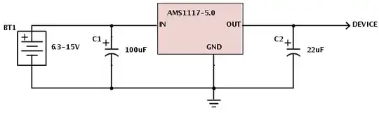

Currently my prototype is built on a 2-layer PCB and uses an AMS1117-5.0 voltage regulator (SOT-223 pkg) for 5 volts. It uses about 32mA on average (fluctuates between 22 and 42mA). I'm not sure what the startup current is or how to measure it.
Based on the datasheet for the regulator, with a dropout voltage of between 1.1 and 1.3, I am speccing the device as requiring between 6.3 and 15 volts. (If I use a Schottky, I'll need to increase the minimum accordingly.)

Current schematic with no protection:
device schematic

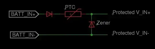

So for polarity reversal causing no damage and requiring no fuse replacement you can use pretty much whatever diode you want and put it in series so that "normal" current flow passes through the diode only if properly plugged in. With the current requirements and voltages that you're working at, this shouldn't be an issue. A simple silicon diode should be fine.
For overvoltage you're going to want a circuit more like what Nick Alexeev suggested in the comment. Essentially a zener diode with a PTC or other type of fuse. The Zener should have a value which is less than the maximum input to your regulator. Quick example schematic
So basically, if you reverse batt_in+ and batt_in- the first series diode will prevent any current from flowing and protect your circuit. If batt_in is greater than the breakdown voltage of the zener, it will start pulling down a lot of current, and blow the PTC fuse.
The only extra thing you might do, is to guarantee that the startup current doesn't exceed your PTC's current limit, you can place a resistor on "protected V_IN+" or "protected V_IN-" (in series before the regulator and decoupling capacitor) such that:
(BATT_IN+ - V_forward_diode - Resistor*Maximum_expected_load) >= Vmin_regulator
For the desirability of any specific characteristics for the PTC, the diodes, and everything else, it all depends on your application. In general, I tend to wing it unless I have a real reason to crunch the numbers. I'm also a bit too tired (on my way to bed) to really get into how to calculate what these values should be, but if you need this info ask in a comment and I'll post some tips on getting the numbers.
Though, why not just use a polarized connector for the batteries so that you don't have to worry about whether the connector is plugged in backwards? And in what context are you going to overvolt? Think about these questions too when trying to answer a more complicated design choice (a polarized connector is easier than adding an extra diode, and is less likely to lead to extra design considerations).
Hope that helps!

  • Watch out for the voltage drop across the forward-biased diode! It will be 0.7V for normal diodes and 0.3V for Schottky diodes. This will cause it to dissipate heat in normal operation. – pjc50 Nov 13 '12 at 13:57
  • I agree a polarized connector would be ideal. This round of product has screw terminals marked Vcc and Gnd and takes bare wires to allow end-users flexibility. I'm not providing/selling a power supply for this device at this time, so I am recommending a configuration to the end-user. I don't know how likely it is that someone will provide over 15 volts. – JYelton Nov 13 '12 at 16:49
  • @Kit If you have time I would like a bit more info on selecting values. For example, for the series diode I would like to have a minimum voltage drop to keep 7.2 volts as a viable supply. I don't know what peak reverse voltage I should look for, nor what values for continuous forward current or surge current. – JYelton Nov 13 '12 at 20:23
