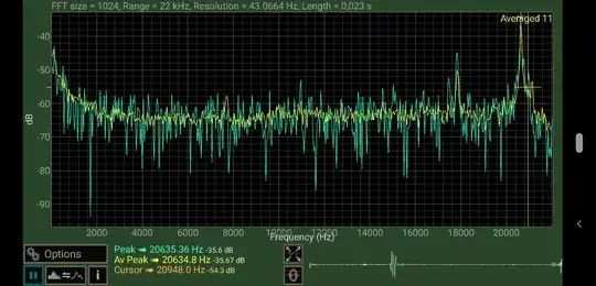

I have a Dell LCD (LED backlight) without speakers which produces an audible "hiss" when connected the HDMI input. DisplayPort much less. I have recorded the following spectra:
monitor off (this is about the minimum the phone can record, so it's not very stable) monitor off
monitor on HDMI UHD @30 Hz monitor on hdmi
The noise starts at about 9 kHz and goes up to 20 kHz.

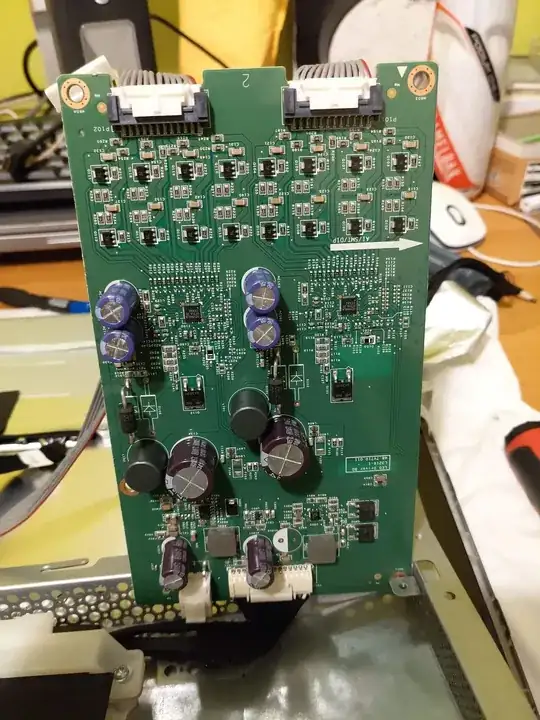

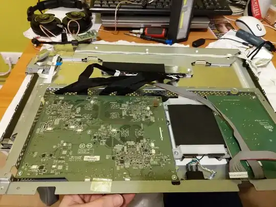

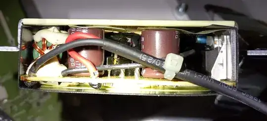

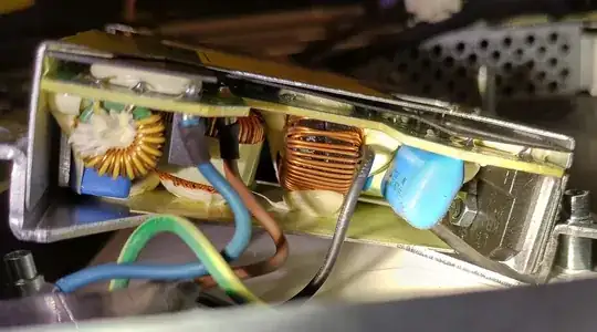

I opened it. It sounds like the noise comes from the PSU, but I cannot open it further to check inside it. See photos.
PSU
Or LED driver board
Opening the PSU would destroy it.
However, I measured the voltage at no load or when the monitor was turned on, but only the electronics was powered (no LCD, no inputs, ...). The voltage was 19.8 V. It matches a text on the silkscreen of the main mainboard which refers to "19 V USB 3".
The PSU has only that single output, no feedback or anything. I think I could replace it with an external one providing stable 20 V (my tester in AC mode and 20 V scale gave 0.01 V "true RMS"). I'm not sure about the current rating I would need. If Dell states 120 W maximum, I need a 6 A PSU or better. I guess I can replace the AC socket with a DC barrel socket, which are rated up to 10 A. Laptop power supplies already provide 19.5 V and sometime 7.6 A, however I have no idea whether the output voltage is stable enough for the purpose. There is also a Mean Well 20 V 6A, 180 mV p-p with DC barrel plug.
In any case, I hot glued the inductors I could see, but the effect is limited.

  • @winny I think it's the power supply: the noise is strongest on the side of the power socket and I see through the cooling grid some relatively big capacitors. But I understand, I have to focus on the capacitors connected to the noisy inductor. – FarO Mar 20 '20 at 15:38
  • Sounds more and more likely. ~9 kHz is also the crossover frequency of the output on most power supplies. – winny Mar 20 '20 at 15:46
  • @winny I survived. I updated the post. – FarO Mar 30 '20 at 22:15
  • Good! Power supply is probably fine. The driver board, can you see any leakage at the bottom of the electrolytic capacitors or swelling near the top? Can you turn it on while disassembled and take a closer listen without electrocuting yourself? – winny Mar 31 '20 at 09:11
  • @winny I did, but the LCD panel was not connected because some cables had to be disconnected to get there, so the PSU was running at very low power. Still, the sound was coming from it, or largely from it. No leaks seen anywhere, the LED driver board (which in fact powers everything, the PSU has only one output) looked perfect. I think I will replace the PSU with an external one. I could try to power the display with an external PSU (DPS5005) just to verify and to check it with the oscilloscope to see how clean the PSU needs to be, but I'd like to avoid opening it too many times. – FarO Mar 31 '20 at 09:29
