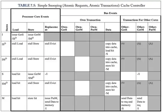

I will let somebody else provide a full answer to your questions. For now I've included a table of state transitions for the MSI protocol taken from Sorin, Daniel J., Mark D. Hill, and David A. Wood. "A primer on memory consistency and cache coherence." Synthesis lectures on computer architecture 6.3 (2011): 1-212. Observing an Other-GetM (BusRdX) when in M state will transition to I state and send the data to the requestor. I imagine both variants could be considered "flavours" of MSI.
Theoretically, a CMP's bus could be split into control and data components where the former is the only part snooped. In this case, it wouldn't be possible to transfer lines between cache controllers and the data communication would need to happen through shared memory. I'm not sure if such designs occur in the wild though.
MSI transition table
