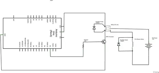

Edit: After extensive discussion with HikeOnPast (thank you) and then a brief hiatus, I am back with more specific questions. The edited question follows...
Let me start by saying this is my first Arduino project, and I'm a little confused with some of the hardware.
I am attempting for my first project to make a fingerprint door lock, and the only thing that's stopping me from purchasing the components is knowing if my setup is going to work or not.
The basic schematics of the idea are below:
https://i.stack.imgur.com/MH8rr.png
Old image: https://i.stack.imgur.com/3dT8v.jpg
Is this an acceptable setup? For the actual fingerprint reader, I was going to use this one, https://www.adafruit.com/products/751, which upon receiving the correct fingerprint, tell the Arduino to send power to the lock to unlock it for a certain amount of seconds.
The coding I can handle.
The strike that I will be using is similar to the "Electric Door Strike for Schlage Locks," and the power supply will be similar to the "Linear Corporation AAE00381 12-Volt DC 2000ma Power Supply."
Specific questions:
  1. Do these schematics make sense? After discussing this with HikeOnPast below, I believe I copied his schematics correctly. I'm not sure what he meant by "12V Return" from the strike but I assumed it is the same as sending it back to the power.
  2. Is there a better, more efficient, or simpler wiring setup?
  3. Would the above work with an electromagnet substituted for the strike (I'm assuming yes, I would just need to find parts that are compatible with the magnet)?
Charlie

To be clear, what you posted is a wiring diagram, not a schematic. A schematic of your circuit would look something like this:
Would a 2N3904 NPN transistor and a 1kΩ resistor work together in this scenario
1kΩ is probably fine. We don't know the peak and holding current for your magnetic strike (they rarely publish such information from my experience). The 2N3904 is rated for 200mA, likely not enough for your strike. I'd guess that the strike will take around 1A at 12V, so you may want to use a relay to handle the current. For that, you can use your 2N3904, just use it to drive the relay coil (5V, powered from your Arduino, or 12V, powered from your external supply), and use the relay to control the strike. This discussion may be helpful.

Note the flyback diode in the schematic. Even if you go with the approach of using a transistor to drive a relay and using the relay contacts to power the strike, you'll want a flyback diode across both the relay coil and across the strike itself.
The strike is basically a big inductor - once current starts flowing, it wants to keep flowing. Most strikes have a MOV snubber integral with them to suppress spikes, but a reverse-biased diode will do a better job of eliminating transients. A lot of strikes are made to work on either AC or DC; a MOV works for both, but the reverse-biased diode can only be used when applying DC.
The power supply I linked to.
Should be fine, based on the limited information we have. If the strike needs 2A or less, it should work.

  • Thanks for the info. As for the schematic, sorry about that. Fritzing has the option to output a shchematic (I believe), would I be better off outputting that from now on if I need advice? Also, is the diagram that I have suitable for the strike, or am I missing anything. The power supply I linked to. Can you tell if it has two wires or one? – Charlie Nov 08 '12 at 14:10
  • Schematics are more design-centric, while wiring diagrams are more assembly-centric. I'd post the format that best suits the question you are asking. I've edited the answer with the other answers to your questions. – HikeOnPast Nov 08 '12 at 17:45
  • Okay, I redrew the schematic: http://i.imgur.com/tChKv.png Is this correct, using the diode in the correct place? The only thing I couldn't figure out from the schematic you posted was the location of the power supply, so I assumed where it was. And when I was talking about the two wires, I was talking about the DC power adapter. wondering if it had a negative and positive wire, which I should've realized it does. Also, why do strikes such as this one have 4 wires, instead of 2: bitly.com/VJOWGQ – Charlie Nov 09 '12 at 01:00
  • @Charlie, you've got it drawn perfectly...if you're going to use a high current transistor. I still recommend using the transistor to drive a relay, and using the relay to drive the strike. I've added the answer to about the strike, above. – HikeOnPast Nov 09 '12 at 03:19
  • Awesome! "I still recommend using the transistor to drive a relay, and using the relay to drive the strike" could you provide a schematic of what you mean here? Also, how do I know which wire from the DC wall supply, the negative and positive, goes to either the diode or the transistor? – Charlie Nov 09 '12 at 03:25
  • See edits, above. – HikeOnPast Nov 09 '12 at 04:44
  • Okay, is this correct? http://i.imgur.com/GpVm0.png – Charlie Nov 09 '12 at 22:13
  • Not quite. Compare the relay contacts in your design to what I posted earlier. Trace the flow of current from the power adapter to the strike. How will this ever turn off? – HikeOnPast Nov 09 '12 at 22:43
  • What do the "NO", "NC", and "C" labels mean? Are they a part of the relay? I'm attempting to fix my design, but that's confusing me – Charlie Nov 09 '12 at 23:45
  • Search for "SPDT relay". http://www.ehow.com/how-does_4911787_spdt-relay-work.html – HikeOnPast Nov 10 '12 at 00:08
  • Wouldn't that be superfluous because the strike itself includes an SPDT relay? Or does it not? – Charlie Nov 11 '12 at 16:15
  • Where do you see that the strike has a relay in it? – HikeOnPast Nov 12 '12 at 05:09
  • Well it has functions such as normally open, and normally closed. At least this one does: http://www.ebay.com/itm/ws/eBayISAPI.dll?ViewItem&item=160364888288&ssPageName=ADME:X:RTQ:US:1123 – Charlie Nov 12 '12 at 17:59
  • Did you watch the video in that link? Those terms refer to whether the strike requires power to unlatch or power to stay latched. Same terms as a relay, but the strike is just an inductor (or pair of inducators for dual-voltage models like the one you initially linked to), and does not have a relay built in. – HikeOnPast Nov 12 '12 at 18:55
