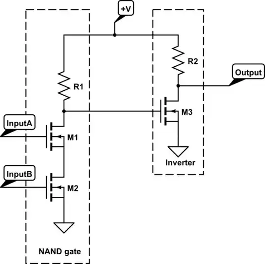

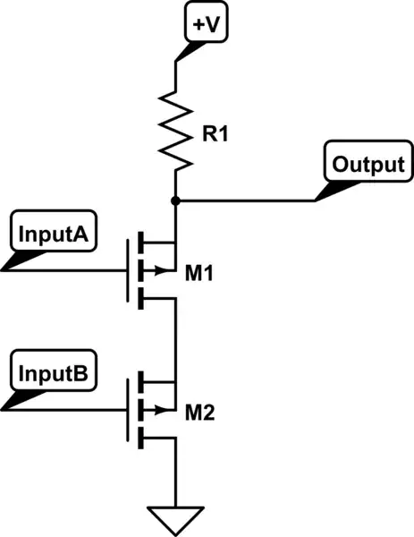

This is one way to make a simple NAND gate: Note that both input A and input B must be HI to connect Output to GND and override the pullup resistor R1 in order for Output to be LO, otherwise output will be HI.

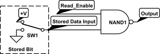

So how do I use this to make one bit of ROM? I can do this
schematic
simulate this circuit
The "Read_Enable" input is driven HI whenever I want to place the stored data bit on the output. I tie the input line for the Stored Data Input HI or LO depending on what I want to store. Note that since I am using a NAND gate, I would tie the input LO in order to output a HI, and I would tie the input HI in order to output a LO. If I used a AND gate instead of a NAND gate, I would tie the input to the same signal I wanted to output, but an AND gate takes more transistors which would have made my first transistor-level circuit more complicated because I would need to place an extra transistor on the output of my transistor-level NAND gate to turn it into an AND gate:

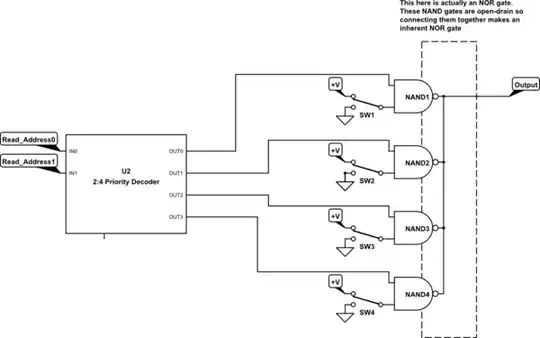

The next step is to tie a bunch of these together and make it so you have a bunch of bits storage cells connected to the same line, and make it so you could select which bit storage cell you wanted to read from. I used transistor and gates here because it might be easier to understand.
schematic

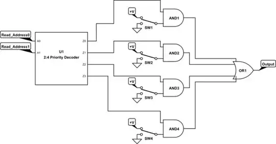

A version of this using regular push-pull AND gates and OR gates might be easier to understand:
schematic
But using logic gates is kind of overkill, especially when you need a lot of bits. It's just easiest to understand it with logic gates.

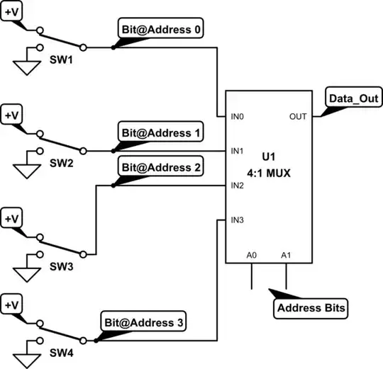

The method shown so far has a read signal for each bit that passes it to the output. This is very similar to a multiplexer where you tie the multiplexer inputs HI or LO depending on the bit you wanted stored, and then use the address lines to connect the output to the input line storing the bit you want to read. This could also be considered a lookup table as well.
schematic

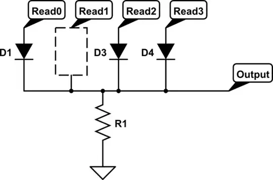

But you can see that it can get hectic with so many parts so it can be less parts to do the same thing with a diode instead of transistors.
schematic
In this example, you drive one and only one of the Read lines HI to select which bit you want to read. All the others are LO. The bit is stored based on whether or not a diode is actually there. If a diode is there, then when the Read line is driven HI, it will pull the Output HI. But if no diode is there then the resistor will continue to pull the Output LO.
You can make enormous grids like this with many fewer and cheaper parts than logic gates. You can also make it so driving one line HI drives the line for multiple outputs HI so you can read multiple bits at one time in parallel.

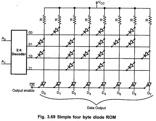

In my example, above, there was a pull-down resistor, pull-up diodes and you drove the read line LO. In the example below, it is the oppoposite: there are pull-up resistors, pull-down diodes, and you drive the read lines LO (via the decoder, it drives the active output LO and the inactive outputs are either HI or high impedance).
enter image description here Taken from: https://www.eeeguide.com/rom-read-only-memory/

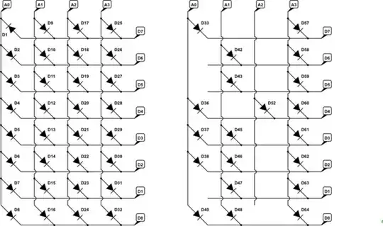

schematic
Figure 1. A simple ROM arrangement using diodes.
Here when an address line (A0, etc.) is pulled high any of the data lines (D0, etc.) fed by diodes will be pulled high. Where the diodes are missing the output would be low (although a pull-down resistor on each data line might be required to make sure). The arrangement on the right, if read sequentially from left to right would return data:
Table 1. ROM data.
    DDDDDDDD
    76543210
A0  10011101
A1  01101111
A2  00010000
A3  11111111
After you've done a few dozen of these you'll see why EPROM was much more successful.
