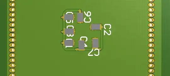

Basically it's just a breakout board or PIM board. All nets are on top side of PCB. I'm thinking of using bottom as a ground plane.
Is it a good idea to fill entire top side of PCB with copper polygon connected to + and bottom side of PCB covered with ground plane and have caps under IC connected with vias? Entire board will then act as a capacitor. I read some where that it's a good technique. By this I'll have perfect trackless ground plane on bottom side of PCB but viaed supply plane on top. And I'm not quite sure about the board acting like a cap at all. Is it a good thing to do? Why?

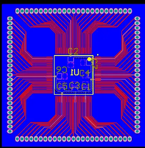

I designed something but yet not sure if its a good one.
By this I connected all VDD pins together. ( This is important for my project). But notice that power pins of MCU are connected to supply bu that track and also directly from header pins. Is it a problem? Does it couse noise and why?:)
Then I filled bottom layer with polygon connected to ground...
