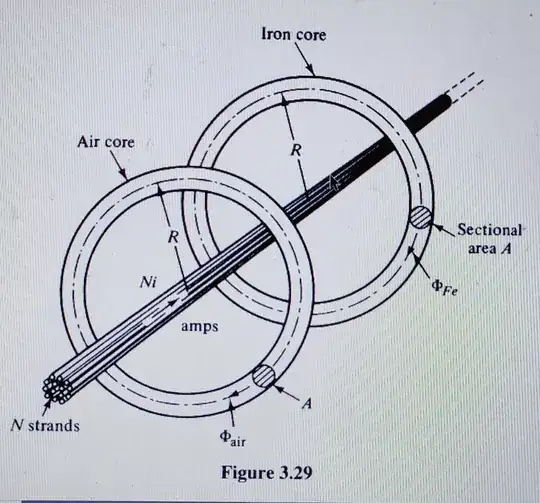

I was just reading Electric Power Engineering by Elgerd when I came across these statements about flux I couldn't fully understand:
  1. "By experiment, we can confirm a most interesting characteristic of the flux. If we keep the iron core position fixed but move the cable to any position inside the core window, the flux will not change. (The reader should contemplate what happens to the flux in the air core under the same conditions.)"
Why is this so? Shouldn't changing position increase flux in the regions of the core close to it and decrease in the far away areas? Is this the case for air core?
  1. "The flux will not change even if we bend the cable into any conceivable shape as long as the total current Ni remains unchanged and as long as it passes through the core window. In fact, the magnetic flux will remain unchanged if we replace the N-strand cable with an N-turn coil carrying a current i as long as the product Ni stays constant."
I have trouble imagining what the N-turn coil he's referring to would be placed like. Wouldn't it cause NI going in and coming out both?
Also, what would happen if I change the shape of the iron core itself keeping the cable straight? How would flux change then?Picture given in the book

The magnetic core has low reluctance. Low reluctance means that it is a very attractive path for magnetic fields to flow through compared to air hence, most of the circulating flux in the toroid will be constant largely irrespective of the conductor position. This is because the magnetic field strength is dictated by current flow and it is assumed, for this explanation, that current flow is constant.
There will be some flux in the air but, for a high permeability core (low reluctance) it will be a small percentage.
If you made the toroid extremely large, the path the magnetism travels along gets extremely long and reluctance increases linearly with the circumference. If you continued this train of thought, you will get to a point where air carries the most flux because it is seen by the flux as being the preferred path due to it having lower reluctance than the massively oversized and distant toroid core.
See my answer here for a mathematical explanation of how reluctance works in a similar type of problem.
If N parallel strands carried N amps, this is the same as N looped strands carrying 1 amp. Parallel strands are counted as one loop.

If you have a finite permeability core with an arbitrary shape, then things are very complicated, you'll need to do 3D integration in mixed materials, not fun. In general, the flux varies somewhat with the cable position.
We can make some simplifications under certain circumstances.
1) Core has infinite permeability. All the flux travels in the core, the cable position does not matter at all. The flux is constant due to the topology, that it loops the conductor, and takes all the flux.
2) Core has very high but finite permeability. Almost all the flux travels in the core, and the core flux barely changes as the cable position changes. As the relative permeability of the core gets closer to one, the flux becomes more sensitive to cable position. As a rule of thumb, if the core is iron or ferrite with a relative permeability of (say) 2000, then the change in flux as the cable is moved from middle to edge will be less than 1/2000th, which for most purposes is negligible.
3) Core is air, and the winding is a uniformly wound toroid. This is called a Rogowski Coil. Although the flux in any part of the torus varies as the central cable moves, the total flux linkage, and therefore the voltage induced in the winding when the cable current changes, is constant due to the symmetry properties of the torus.
Even with a circular core, a finite permeability means there will be some small sensitivity of flux to cable position.

Regarding the position of the wire not affecting the result: This can be proven mathematically, but the math is very complicated. A good college professor can most likely do it (I recall seeing it done once). Sometimes, it is best to just trust the conclusions of the experts.
Regarding N-turns: It is the current that passes through the hole that matters. If the wire loops around and passes through the hole again and again (you have multiple (N) turns of wire going through the hole), the equivalent current that the torroid sees is the product of the number of turns and current.
If the shape of the core is not circular, then the symmetry is lost, and the position does matter somewhat.
Regarding an air core: The rule still applies for the area defined in the figure. However, the amount of flux in this area is much, much less. The flux is not contained in this area. An iron core is useful because the flux will mostly be contained within the iron core (path of least resistance). Then, secondary windings can do something useful.
