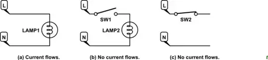

- For electrical energy to be consumed current must flow.
- Air is a very good insulator. We use air as an insulator on the high-voltage lines you see criss-crossing the country.
- When we open a switch a millimeter or so the gap is sufficient to prevent current flow.
- The gap between the contacts of your socket is much more than a millimeter. No current will flow from one contact to the other. No energy can be consumed.
