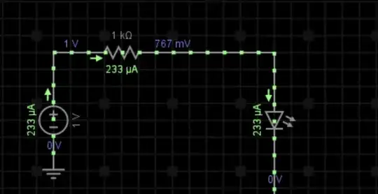

In the following diagram:
The current is 1 mA from:
V = IR
R = 1 / 1000 = 1 mA
However, when I add in an LED with forward voltage 1V:
Why does adding in the LED drop the current as well? Does an LED have resistance as well? (I thought an LED only causes a voltage drop but doesn't have resistance). How does that work?

    LED only causes a voltage drop ... what do you think that happens to the voltage drop across the resistor then? – jsotola Feb 02 '20 at 00:34
  • @jsotola Actually, I would expect the node showing 767 mV would be 1V (as the forward voltage of the LED is 1 V). – Michel Keijzers Feb 02 '20 at 00:41
  • David, that's a level 2 or above question, because the voltage is low and you are including substantial resistance, too. – jonk Feb 02 '20 at 00:52
  • David, go into Falstad with the circuit you used and let us know what the LED model parameters are. (These will be Level 2 model parameters: saturation current, emission coefficient, etc.) If we grab those, the simulation can be explained. – jonk Feb 02 '20 at 02:14

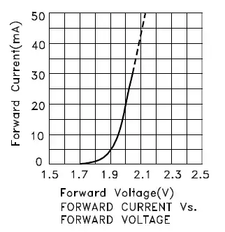

A bog-standard red LED has a forward drop of about 2 volts at 20 mA so yes, it has a significant impact in what current might flow when the supply voltage is only a few volts: -
So, with 2 volts across it and 20 mA flowing, the perceived resistance is 100 ohms. With 1.9 volts across it, the current is only 5 mA and the perceived resistance has risen to 380 ohms. At only 1.8 volts, the current might be 1 mA and this means it looks like 1800 ohms. Do you see the issue?
For instance, if your supply voltage was only 1 volt then forget it because it won’t overcome the innate forward voltage of the LED and, barely nano amps will flow.
Other LED colours can have significantly higher forward voltages so, what you are trying to achieve depends on the LED type.
So, like the game rock, paper and scissors, the LED dictates current flow at low voltages but, at higher voltages, the series resistor wins.

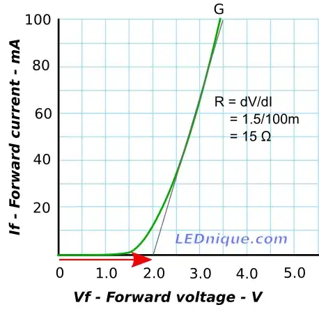

An LED does have resistance in that it resists current flow. If it didn't there would be no voltage drop across it and, since P = VI, with V = 0 it could not consume any power or produce any light. We don't treat it the same as a resistor though because the relationship between voltage across an LED and current through it is not linear. (Ohm's brilliance was showing that there is a linear relationship for a true resistor.)
Hopefully the following will help.

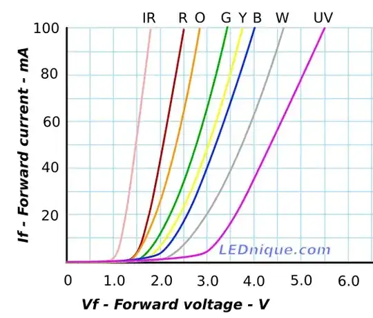

LEDs do not have a linear relationship between current and voltage so they cannot be modeled as simply as a resistor using Ohm’s Law, V=IR. We can, however, make a simplification and model them over a range of currents as a combination of a resistor and a voltage source.
Figure 1. An LED can be approximated as a resistor with a fixed voltage source.
If we look at a typical LED IV curve we can see that it is approximately linear over much of its useful range. This allows us to model the LED as a resistor and voltage source.
Figure 2. LED equivalent circuit model.
In Figure 1 the grey line is reasonably close to the LED curve from 20 mA to 100 mA. We can work out the resistance that this represents from Ohm’s law V=IR but in this case we will look at the change in voltage and current in the area of interes.
$$R = \frac {ΔV}{ΔI} = \frac {3.5–2.0}{100m–0} = \frac {1.5}{100m} = 15 \ Ω $$
We can also see that the line crosses the X-axis at Vf = 2.0 V. Our equivalent circuit for this region of interest is (referring to Figure 2) R1 = 15 Ω and V1 = 2.0 V.
