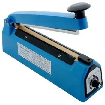

For long term storage, what I usually do is put the item in an anti-static plastic bag, put some desiccant packets if available, then seal it (video) using an impulse sealer. This method has yet to fail me.
The plastic, desiccant, and impulse sealer can be acquired for cheap, at least in the Philippines.

    @NIN That was what was mentioned earlier when by crasic when he mentioned anti-static bags. You can get a heat sealer for those bags too. You can also add in dessicant pouches before you heat seal or in extreme cases you can vacuum seal it. – DKNguyen Jan 28 '20 at 17:38
