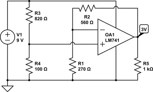

As a beginner I tried to make a simple DC circuit with an opamp on a single supply. This is what I came up with:
schematic
I use R3 and R4 as a voltage divider to get 1V between the inputs of the opamp, and R1 and R2 in the noninverting configuration. I tested this circuit in a few simulators and they show 3V at the output.
$$ Gain = 1 + \frac{R2}{R1}=1+\frac{560}{270}\approx3 $$

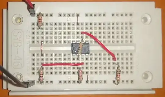

Picture of circuit
I built the circuit and measure 5.64V where I expected 3V. What am i doing wrong?

    What you're doing wrong is expecting a 741 to operate off a 9V single-supply. I suggest you search this stack for all the many '741' questions and read about why that's a problem. – brhans Jan 15 '20 at 20:44
The LM741 (datasheet here) has a "common mode" input voltage range of not within about 3V of either supply.
In your example, with a 9V supply, you must have an input voltage in the 3V-6V range (0+3, 9-3) for the opamp to function correctly.
  • The absolute maximum input common mode range varies with supply voltage. It is usually not well covered in data sheets and if stated is usually specified at a single relatively high supply voltage. I specified a Vcm of "not within 3V of either supply", based on a Vcm of +/-12V for a supply of +/-15V in the above cited datasheet. AT lower supply voltages some suggest that Vcm may be within 2V of either supply - you'd need to establish this from a relevant datasheet spec - which may not be available. It's a lot easier to use an eg LM324/358 (see below) which has a Vcm range of 0-(Vcc-1.5V).
The recommended minimum supply voltage is +/- 10V = 20V total, but a lower supply voltage can be used. How much lower is not always well specified in datasheets but a lower limit is obviously not less than the common mode input range - ie with a supply of 6.1V, if Vcm is +/-3V, you will have
6.1-6 = 0.1V of allowed input swing.

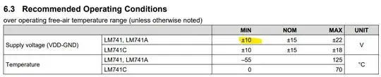

    Using the TI data sheet for the uA741, table 6.2 Recommended Operating Conditions, they spec Vcc+(min)=+5V and Vcc-(min)=-5V. I agree that those specs really don't mean much, as hardly any other parameter is spec'd at those voltage. Most parameters are spec'd at +/-15V supply rails. You use it outside of those values at your own risk. – SteveSh Jan 15 '20 at 22:09
