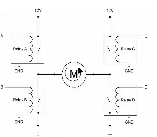

The relays would need to be wired up in an H-bridge configuration. The RPI pins can't supply enough current (and probably not the correct voltage either) to drive the relays, therefore you will need to drive transistors with the RPI and the transistors drive the relay coils.

I would focus on the H-bridge relay part first to drive your actuator in both directions. You need that either way and could probably slap one together in about 10 minutes if you had all the parts. Once you finish that to the point where you can manually apply signals to the relays to turn the motor in both directions, then you can focus on how to limit its motion or trigger its motion automatically.

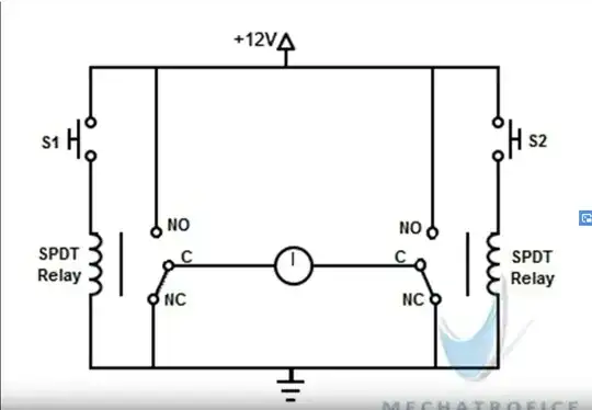

Since you seem to have no idea what it is you need, here are some starting materials:
enter image description here https://www.youtube.com/watch?v=nMHETW-zOrQ
Holding one button turns the motor one way. Holding the other other button turns the motor the other way. It turns endlessly as long as you hold the button so if you want it to stop you need limit switches to disconnect the motor once it hits an end point. The linear actuator may have them integrated.
NO stands for normally open and NC stands for normally closed. Basically the default state of the relay contact when the coil is unpowered. Those relays are SPDT (single-pole, double-throw relays). Single pole because it has one path through it at any one time, and double-throw because it can switch the aformentioned path between two separate possibilities. If you can't get SPDT relays, you can use twice as many SPST (single-pole, single throw) relays instead. Single-pole because one path through it, and single-throw because it switches between one possibility for that path.
If you want to use a Raspberry Pi for this, then it will be driving the relay coils in some way based on its reading of a button. The RPI will not be able to drive the relay coils directly from its pins because it cannot supply enough current and probably not enough voltage. You will need to drive transistors (which can be driven by the RPI pin voltages and currents) to control a larger current which will in turn drive the relay coils, which will in turn control the even larger current that drives the motor.

What if you build the two-button manual circuit I posted (you likely need to do that anyways as an incremental step if you don't know what you're doing), and then just leave it like that instead of implementing the RPI? I'd bet though that if you just built the button version and have it working then your manager will suddenly find more important things that need to be done.

  • @KamilahClark You need relays, as described above and buttons. I would advise you to build the configuration posted first as an incremental step since you need to do anyways if you don't know what you're doing. You might be able to just leave it at that since its perfectly functional. But if your manager still keeps pushing then you need the PICAXE programming cable, a few 100nF thru-hole ceramic capacitors, a few thru-hole resistors, transistors, diodes, a voltage regulator (maybe a wall-wart or one that goes onto a breadboard), a breadboard to build everything on. – DKNguyen Jan 15 '20 at 01:14
  • Breadboard is faster and can be fixed, but soldered protoboard is more reliable. You would need to build the circuit on both if you don't know what you're doing but end up needing it to be reliable for a performance. – DKNguyen Jan 15 '20 at 01:18
  • At this point, my manager is just going to have to accept this since we have a budget to follow. Cutting out all of the PICAXE and etc, what are the things I need to buy? I'm on amazon since I need to purchase everything today. – Kamilah Clark Jan 15 '20 at 01:28
  • @KamilahClark The things you absolutely need are just what appears in the schematic above. The linear actuator with limit switches, two SPDT relays (or four SPST relays), and two buttons. The primary contacts of the relays must be able to at least support the voltage and current of the motor in DC. The buttons must be able to support the voltage and coil current required by the relays in DC. Also, don't forget to look at the voltage the buttons can be used with and the voltage that the relay coils require. You probably don't want a 120V relay coil. You also need wire, maybe connectors. Power. – DKNguyen Jan 15 '20 at 01:32
