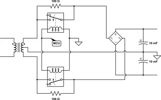

I have a transformer with several secondaries, and this is how I'm planing to control the inrush current:
schematic
I'm using a resistor to limit the inrush current and MCU will energize the relays after a few seconds to bypass the resistors.
  • Can I use a single resistor and relay on the primary to limit the inrush current instead of using a relay for each secondary?
  • How can I activate the relays without an MCU, using only analog circuitry?

  • If you use this sort of circuit you should have some way to inhibit the circuitry connected to the power supply from drawing current and dropping excessive voltage across the resistors, otherwise you could still get a large pulse of DC current which could weld the relay contacts closed. – Spehro Pefhany Jan 11 '20 at 18:54
  • @SpehroPefhany So what should I do? – ElectronSurf Jan 11 '20 at 19:03
    Andy's answer, as usual, is a good one. The only caveat aside from a bit of heat, is that it won't limit the current surge by nearly as much if the power is interrupted and re-applied with the NTC hot (assuming the capacitors discharge). If you still want to use a relay find a way to inhibit the circuitry, which may or may not be easy. When I designed a 3-phase motor controller for a sampling system it was easy to not drive the IGBTs until the relay had actuated- common control circuitry. Your details will be similarly dependent on the details of the circuitry attached to the power supply. – Spehro Pefhany Jan 11 '20 at 19:35
  • I understand why you deleted your newer question @ElectronSurf - it all gets very complicated when you start to impose one regulation because, that drags in the rest of them. – Andy aka Jan 12 '20 at 00:31
  • @Andyaka I'm still confused and unsure on what to do but that question wasn't on point, thanks for the help. – ElectronSurf Jan 12 '20 at 06:11

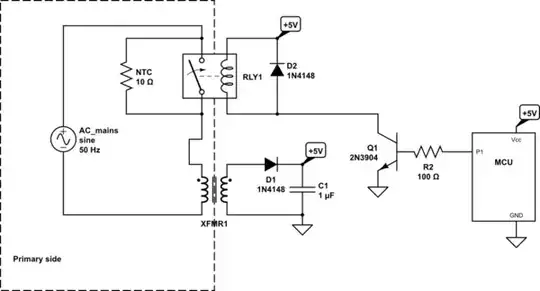

You asked in a different question (which you removed?) about putting an NTC on the primary and bridging it with a relay.
If you care enough about light load power consumption since an NTC will waste power, have issues going from light to full load and voltage dip while your NTC is heating up or similar, my recommended solution is NTC + relay on the primary side. As Andy said, inrush into your transformer is zero crossing insertion and transformer design dependent, but your NTC will handle that too if you put it on the primary.
The upside of an NTC over a straight resistor is in case your relay fails to open. At tens of watts of load or higher, that resistor will not be possible to have in series during operation whereas an NTC will be, although with some power losses.
The downside of this arrangement, apart from the added cost, is that your relay will bridge the primary to secondary isolation provided by your transformer so you need to use an agency approved relay in respect to coil to contact isolation. Plenty of them in the market to choose from.
