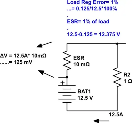

All conductors , semiconductors, capacitors and inductors have resistance even regulated power supplies.
  • Regulated supplies amplify the error between desired output and actual but response time is bandwidth or slew rate limited.
  • Thus load regulation error appears in all regulator specs
  • It can be defined a number of ways.
  • 1st order estimate Zout= ΔV/ΔI[Ω] above some minimal load to avoid other issues.
    • In Batteries and caps, it's called ESR.
  • 2nd order impedance is the storage capacitance which limits slew rate on errors. On Batteries, they recover quickly from a brief short. This memory effect is due to another effect from Double-charge layer effects which are modelled as another RC with bigger C and R that remembers what the brief short circuit that the discharge depleted.
Let's look at a simple model.
schematic
I have discussed the models from memory effects of batteries elsewhere, if you are interested.
We use many different symbols for the internal resistance, Rs, Ri, ESR, \$r_{be}, R_{ce}\$ and for inductors, DCR and for Zeners, Zzt.
Let's look at one of the cheapest LDO's ($0.05653 on 3k reel)
recall Zout= ΔV/ΔI[Ω]
here Zout= ΔV_{out}/ΔI = 30 mV / 150 mA = 200 mΩ
Notice errors include Vout tolerance over temp , Line REG and Load REG.
Also note the fast rise time in the spec. This tells you slower loads may be regulated better due to high gain , but this has an internal rise time limit to respond, which is why external Low ESR caps are needed to reduce any source of high freq. ripple.
