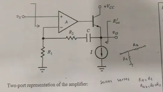

update: I have read similar questions on ee.se, they helped a bit, but it is still hard to understand the type for example in the question in figure. Maybe, you can just explain specially the question below.
Series-shunt, shunt-shunt, current mixing, voltage sampling,... All these keywords became a total mess in my head. I cannot find a logical way of how to categorize those feedback types. The picture is just for an example, I would be appreciated if anyone comes up with a neat way to identify the feedback types and when it is sampled or mixed.

There is a clear way to differentiate between the two types of feedback (Current/Voltage).
If you short the output (making Vout = 0), and the feedback signal goes to zero, you've got Voltage feedback (sampling the voltage).
If you disconnect the load (making Iout = 0), and the feedback signal goes to zero, you've got Current feedback (current sampling).
If the error signal is fed back in parallel (shunt) with the input.
We have a (shunt/parallel) feedback.
And we have series feedback if the error signal is fed back in series with the input signal

    @G36...in principle I agree, of course, to the shown way to distinguish between the variuous feedback types....on the other hand it is clear that in many cases - in particular for transistor circuits - we have in reality a mixture between two kinds of feedback (and not a single type). Example: Voltage sampling requires that disconnecting the feedback path must not alter the open-loop gain....this requirement is not fulfilled for the shown circuits (much better - nearly ideal - fulfilled for an opamp). Hence, we have a mixture between voltage sampling (dominating) and current sampling (minor). – LvW Jan 02 '20 at 15:18

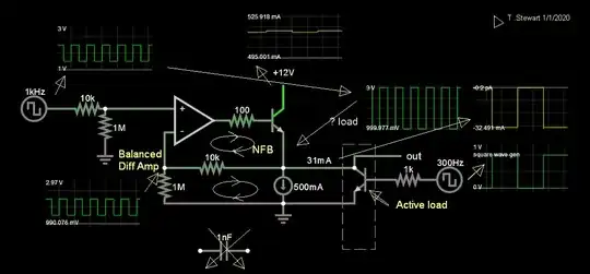

It might help also, just to visualize current loops for positive currents and negative currents with respect to any design simulation. Here your emitter only pulls up and current sink pulls down.
Here I also changed the feedback which could be any ratio such the external Vadj R ratios of an LDO with a Vref.
Notice the Emitter Follower lowers the Zout by Rb/hfe but only for positive current.
If you can imagine it, you can simulate it. Falstad allows you to scope anything "unlocked" = floating trace. Zout=ΔV/ΔI
This is a formal classification, in which these names say very little about the essence of things... because there is no way to convey in two words something that is explained by pages of text. The solution is, while trying to figure out an unfamiliar circuit, to think with simple words and concepts. Once you understood what it is, what it does and how it does, you can "stick" one of these "labels". Let's try doing this procedure with your example above...
First we see two cascaded amplifiers - an op-amp A and an emitter follower. The op-amp is well-known for us... but what is this current source (more precisely, sink) in the emitter follower? What is its function?
Then we see the capacitor C and conclude that, regarding the DC voltage, the follower output is separated from the resistor network R1-R2; so the latter will draw no current from the emitter...
Meanwhile, thinking about the current source, we realize that actually it is not a source... it is a 2-terminal element (dynamic resistor) which IV curve resembles the IV curve of a true current source. We remember that any transistor has such an output curve... so this is probably the collector-emitter part of a transistor with constant base-emitter voltage (current).
Next, we realize that the emitter follower is actually a voltage source producing its output voltage at the emitter. So, we conclude, there are two dual sources - voltage and current, connected to each other. We know (from the course of electrical circuits) this is the perfect combination between them... since the current source sets the current and the voltage source sets the voltage.
It is interesting that when adjusting the DC (bias) emitter current, the transistor adjusts its base-emitter voltage so that to pass this current. Then, when the transistor varies its emitter voltage, the current "source" adjusts its internal resistance so that to keep the current constant... i.e., they interact each other. So the emitter will "see" the extremely high (dynamic, differential) resistance of the current source that is so desired. We remember the same trick is widely used to bias the transistors of op-amp input differential stages. Finally we see the op-amp and the emitter follower are combined to create a buffered op-amp.
Regarding the AC voltage variations, we think of the capacitor C as a short connection since it conveys them. And now we see the ubiquitous voltage divider network R1-R2... and realize it is the negative feedback network needed. Most likely, we know what is the divider input and what the output... and we see its input (R2) is connected to the buffered op-amp voltage output. How is it connected? It is connected in parallel to the output... it shunts the output. So we have found the one of the two so valuable words related to the feedback network input (the way this input is connected to the amp output).
Let's now try to see how the feedback network output is connected to the input side of the amplifier. First we see it is connected to the inverting input (between it and ground). Then we see that the input voltage is applied to the other (non-inverting) input. Besides, both voltage "sources" are connected with their lower ends to ground... and with their upper ends to the differential input. So, we conclude, the two voltages (input and feedback) are connected in series to the amp differential input. Thus we have found the other valuable word.
Then, given the signals are moving from left to right, we coclude the full name of this type of negative feedback should be series-shunt, series-parallel, series-voltage... or voltage-series?
But much more important than the name is to understand the properties and benefits of such a connection...

  • I assume you wil edit your answer. – muyustan Jan 01 '20 at 22:03
  • My idea is to analyze the circuit step by step... to see where the feedback input comes from and where the feedback output goes... and then to classify it... Do you have something against? – Circuit fantasist Jan 01 '20 at 22:09
  • no, I just did not understand whether you finished your answer or will improve it later or not. – muyustan Jan 01 '20 at 22:11
    I think this "dynamic" way of answering is more interesting and useful for reader(s) than the classic "static" answer. Am I right? By the way, I do not know the exact answer... but I hope I will find it while fabricating this story:) If you want, you can contribute in writing the answer in real time... – Circuit fantasist Jan 01 '20 at 22:20
    It is certain that your style is different, which is a nice thing. Thanks for such efforts. I am waiting for your answer to be complete, however, I will be checking throughout the process. – muyustan Jan 01 '20 at 22:24
  • at this point, the most important part is the part you typed with bold. How R2 is connected in parallel to output? Should not the other end of the R2 be ground for this parallel connection? OR do you mean R2 and R1 together by being connected in parallel with the output of amplifier? Also you reverse input and output terms, right? You mean the input of the feedback network which is the output of the amplifier. – muyustan Jan 01 '20 at 23:04
    OK, it really becomes interesting... I will comment it here. What is connected in parallel to the output is not only the single resistor R2... Ohhh... I saw... Yes, R2 + R1 in series (the input of the voltage divider) is connected in parallel... Yes, let's arrange them: The op-amp output (emitter) is connected to the network input... and its output is connected to the op-amp input (output -> input -> output -> input)... – Circuit fantasist Jan 01 '20 at 23:12
  • then, I conclude, taking a connection from the joint point of R1 and R2 to the inverting input of the opAmp does not affect the way how things work since the approximated infinite input impedance of inverting input. – muyustan Jan 01 '20 at 23:20
    Exactly... I tried to correct the text but obviously I still need to improve my English... We are coming to the end, though there are still more interesting things to say about this topic... – Circuit fantasist Jan 01 '20 at 23:26
  • it is a really helpful answer, I don't understand why someone downvoted this. I also am not a native speaker. – muyustan Jan 01 '20 at 23:28
    So what should be the full name? – Circuit fantasist Jan 01 '20 at 23:34
  • I think I am a bit late to play the guessing game :) – muyustan Jan 01 '20 at 23:54
    I was a little rushed but the answer was obvious :) Now I briefly review the writing. It is a good idea to supplement this answer with intuitive explanations for why it is done this way and what the benefits of this connection are. – Circuit fantasist Jan 01 '20 at 23:59
Provided circuit represents AC negative feedback.
How to identify it: opamp signal goes to emitter follower loaded on current source (current flowing through it does not change).
Now if voltage on the base increases then it should increase current flowing through emitter.
As current source will not allow to increase current flow through it, the excess of the current will flow through capacitor (AC) on resistor voltage divider.
At the middle point of the voltage divider potential will increase, this signal will be applied to inverting/negative terminal of opamp.
Opamp signal on inverting terminal will lead to decrease of voltage on the opamp's output -- it forms AC negative feedback loop.
