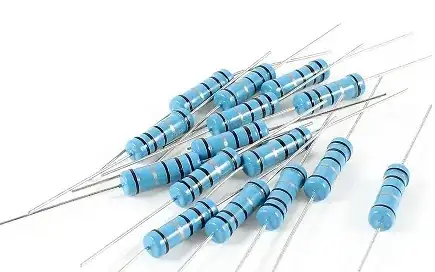

Would a resistor of 0.1Ω be ok for this? Such as one like this:
Resistor 2W
I found some limited to 2W, if we consider a current of 3A maximum, that's a voltage drop of 0.3V and power dissipated of 0.9W, I can compensate for the voltage drop so this is fine.

You sure can. Normally you amplify the voltage before measuring it though. The easiest location to measure is to put the resistor in the ground path so you can process the voltage across the resistor easily, but then this disrupts the ground connection which is bad. Putting it on the high-side means you need a diff-amp to produce a ground referenced signal.

  • @DavidMolony but the minimal gain is 50, with this shunt it would put 15V for 3A current, I guess it is designed for lower resistive shunts. I will try to catch a simple opamp. – Varech Dec 20 '19 at 14:03
  • @Varech Yes, 100mOhms is very high for a shunt, but required if you are measuring very low currents – DKNguyen Dec 20 '19 at 15:20
    Sinking 0.9watts into a 15watt load just for current measurement is not really necessary. Either get a lower value shunt or use 3 of them in parallel to get 0.03ohm... – David Molony Dec 21 '19 at 17:32
