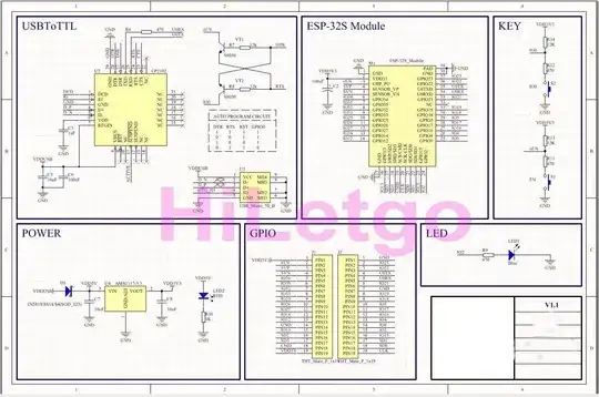

I bought a ESP-32 development board and I'm having a lot of trouble with a button on the GPIO00 pin. This is a strapping pin on the ESP32 chip; when set to LOW on startup, the chip enters the bootloader. There's a convenient button on the development board.
In the schematic for the dev board, there's a 12k pull-up resistor between GPIO00 and 3.3V, and 470ohm between GPIO00 and the button; the button connects to ground. I confirmed this with my multimeter. Given that, I'd expect to read 0.12V when pressing the button. Instead I read 1.33V! This is outside the spec for the low-level digital input, though it seems to enter the bootloader properly.
Does anyone know why there's such a high voltage when pressing the boot button (GPIO00)? Is there anyway to mitigate this if I want to connect my own button to GPIO00?
Schematics for NodeMCU ESP-32S: NodeMCU ESP-32s schematic

    Did you notice the connections to IO0 and µEN in the "USBToTTL" part? – the busybee Dec 19 '19 at 13:51
  • Yes, but I'm not sure what to make of them. I'll check what the states of DTR and RTS are. – csiz Dec 19 '19 at 13:56
  • @thebusybee turns out the DTR and RTS pins are both high, thus actively driving the GPIO00 pin high, which answer my dilemma. – csiz Dec 19 '19 at 14:41
  • So you can make this an answer for anyone else seeking for help on the same question. And, please, mark it. ;-) Or, since you "just" overlooked this detail, delete the question? – the busybee Dec 19 '19 at 19:49

  • Thanks for having a look, the 2 operations are the same. I think @thebusybee answered it in the comment. It seems that the pin is indeed driven high, but by the USB to UART bridge circuit. I'm not sure what is the point of that logic, however at least I know the pin isn't usable... – csiz Dec 19 '19 at 14:52
  • @csiz Good catch, I missed that one (I can also blame the image quality :P), good luck with your project! – eeintech Dec 19 '19 at 15:12
Contrary to what is stated in the ESP32 datasheet the GPIO 0 pin is not usable after boot-up on the NodeMCU style development boards because it's driven high by the USB-to-UART circuitry.
At the suggestion of @thebusybee I measured the DTR and RTS pins as logic high while the ESP32 is running normally. According to the schematic, this means GPIO00 is also set to logic high.
