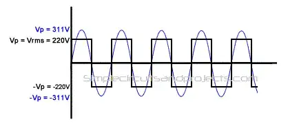

Such inverters usually produce "pseudo sine wave" or "modified square wave" output. Not quite a square wave but a swuare wave with off period so the overall form factor and RMS values are closer to a sine wave.
Image below from here
Very good writeup of aspects involved here (despite heading) What is power inverter
Diagram below is from that site.
