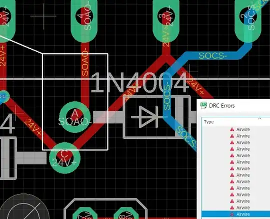

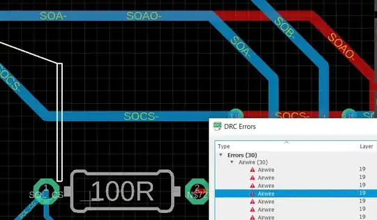

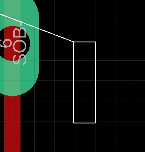

I have designed a PCB using Autodesk Eagle.
After I routing the PC and check for errors from Tools -> Errors, there are lot of airwires (31) like below. But, I couldn't find any airwire.
How to solve this problem?

After rerunning DRC problem is solved as @Huisman mentioned.
If you just select Tools -> Errors, It shows previous errors without updating current status.
Use Tools -> DRC... and click on the Check button to update the errors.
