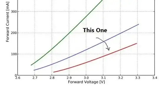

Here's the graph about the LEDs (Red Line).
I want to pass only about 50mA through them so that they remain cool because they would be mounted on a flexible material with minimal heat-sinking. They would require output power from IC -- One Led = 3V x 0.05A = 0.15W

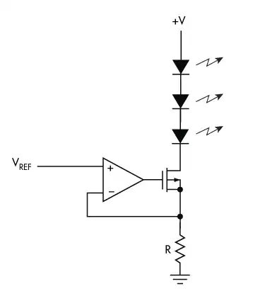

That's when I thought why not design a linear constant current source for mains voltage to drive the LEDs because when I thought about it it did made sense.
Best case scenario: Led driven at 3V @ 50mA each, 34 Leds in series = 102V
3 parallel strings total current = 200mA
Power Dissipation = 110V - 102V = 8V and 8V x 0.2A = 1.6 Watts.
Worst Case: Mains Voltage reaches 130V and thus
Power Dissipation = 130V - 102V = 28V and 28V x 0.2 = 5.6 Watts.
So I personally think that in this case the Linear Approach offers a lot of advantages like very low EMI, low flicker and can be made compact as well because space is limited. Something like this:

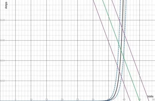

Here, I'm showing three exponential curves that illustrate the variation I've chosen for LEDs that may be drawn out of a bag. I'm also showing two values for \$V_\text{CC}\$, \$4\:\text{V}\$ and \$9\:\text{V}\$, with the load lines for resistors that were chosen in order to hit \$20\:\text{mA}\$ on the middle curve (the "typical" LED case.) You can easily see that a higher \$V_\text{CC}\$ selects a different resistor slope and exhibits a much smaller variation in LED current vs variations in those LEDs.
The above is just one LED in a string. If you place \$N\$ of them in series there will be a distribution around the typical values and while random chance will likely prevent the very worst cases from happening, you can probably expect the string voltage's standard deviation to be \$\sigma_{_\text{STRING}}=\sqrt{N}\cdot\sigma_{_\text{LED}}\$.
Let's say that at \$I_\text{LED}=50\:\text{mA}\$ you typically expect \$V_\text{LED}=3\:\text{V}\$. But suppose \$\sigma_{_\text{LED}}=60\:\text{mV}\$, as I proposed earlier. And suppose I wanted to use \$V_\text{CC}=45\:\text{V}\pm 3\:\text{V}\$, also as I proposed earlier. Then I could use, at most, 13 LEDs in a series. I'd expect random selections into series strings to yield \$\sigma_{_\text{STRING}}=\sqrt{13}\cdot 60\:\text{mV}\approx 216\:\text{mV}\$. So \$3\,\sigma\approx 650\:\text{mV}\$.
If I design a ballast resistor on the basis of the assumed \$V_\text{CC}=45\:\text{V}\$ (I have to pick some value) then I'd come up with the green line below:
The purple lines use the same slope (because the resistor doesn't dynamically change itself) and show what happens under the ripple I considered before. I think you can see that this suggests I would need to seriously re-consider and perhaps choose a much more regulated voltage supply. The ripple I was earlier considering wrecks havoc on regulation, given the small voltage overheads I'm working with.
You could fix this by using fewer LEDs in each string and therefore reserving more voltage overhead for the resistors. But then this is more LED strings and you are wasting more power in those resistors, too.
All in all, I think this is a pretty strong argument against the idea that glen_geek suggested -- just using a ballast resistor. And it is a strong argument for using a low-overhead active current regulation circuit.
