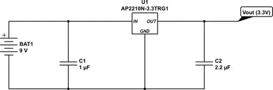

I have a small PCB in which I've added an LDO to convert input voltage to 3.3 V output voltage.
The LDO in using is the AP2210-3.3TRG1 (datasheet). My understanding from the datasheet is that with an input voltage of 4.3 V - 13.2 V. (4.3 V because the manufacturer recommends Vout + 1 V). I'm supplying 9 V input voltage from a battery.
My schematic is as follows:
schematic
I'm expecting to get 3.3 V as output voltage. When I measure the output voltage, however, my multimeter reads only 0.5 V.
I've gone through the datasheet to see if I've misunderstood or missed something, but I can not manage to figure it out. There's also some stuff I do not really understand, which doesn't help.
So some concrete questions. Do I have some mistake in my schematic? Am I misunderstanding how to use this component?
I hand soldered the part on a PCB (with hot air), is it possible I overexposed it to heat?

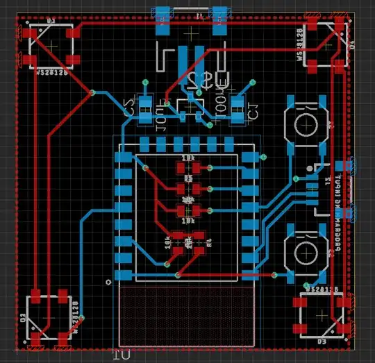

Adding a screenshot of the board design.
board design
resistors on top layer are 10k ohm resistors.
C1 is a 1 uF cap and C2 is a 2.2 uF cap.
U1 is an ESP-12F

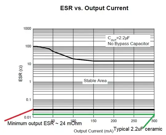

  • If the output capacitor is a ceramic capacitor, then the device may be oscillating (so you would measure an unusual and low voltage with a multimeter); the regulator needs a minimum output ESR of about 24 milliohms for stability which is common in older devices with a P type pass element (a 2.2uF ceramic will be perhaps 1/5 of that). If it is oscillating, it will likely have been severely damaged and would definitely get hot very quickly. – Peter Smith Dec 09 '19 at 15:09

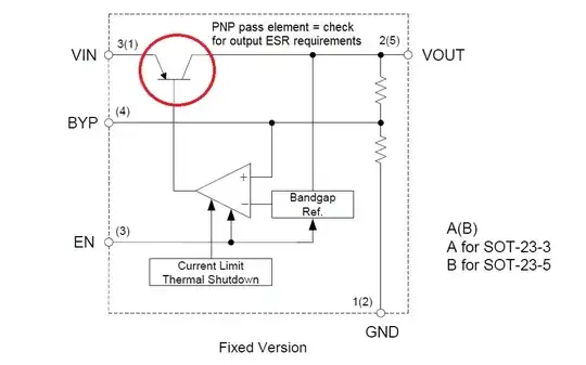

The first thing I consider in these situations is load / power and the next is stability.
Parts with a PNP pass element (particularly earlier and less expensive parts) often require a minimum ESR in the output capacitor path for stability.
Here is the simplified schematic for your regulator:
AP2210 simplified schematic
I have added a note about what I do when I see a PNP (or any P type) pass element:
Going to page 22 of the datasheet we do indeed see a minimum ESR requirement:
AP2210 ESR band
Given the small size of the parts on your PCB, it looks like they are ceramics which typically have an ESR below the recommended minimum.
That leads me to believe the device is possibly oscillating or otherwise unstable which would render it quite hot in very short order.

  • So one could add a resistor (e.g., 100 milliohm) in series with the output capacitor to move the ESR into the stable region, correct? Further, it's a pity that the datasheet is silent about the stable area when a "bypass capacitor" is connected. – Daniel K. Jan 09 '23 at 17:38
I've been soldering PCB's for years and never had a component fail due to overheating. You'll find this is the case for many others (see How to tell if chips overheat while soldering).
If you are using the SOT-23-3 version of this chip, it's pretty much a guarantee you have a goof in your setup (dry solder joint, internally disconnected wire, burned out chip) since you only have three pins to connect. There is no mistake in your schematic, so something else is going on. Try checking the current draw with no load (if it's high, your chip is blown), and double check your pin mapping and continuity.

Pin2, "Vout", appears to be grounded on your pcb.
...and C2 is connected to Pin 1.
That's probably not what you intended.

  • This looks like Eagle; blue is the bottom layer so this is looking at the bottom of the package (ie, as if it's mirrored). It's correct, unless colours have been changed. – awjlogan Dec 09 '19 at 13:37
