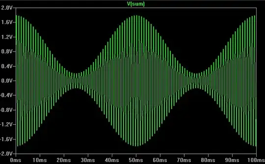

Here's the result of adding 3 sine waves; 0.4V of 980Hz, 1V of 1000Hz, and 0.4V of 1020Hz:-
Nothing was messed with, just 3 separate waves sent down a single wire. And yet we can see a 'carrier wave' and 'modulation'.
But can we develop a circuit that reproduces that waveform without needing 3 separate oscillators? Turns we can, by simply varying the voltage of the 1kHz wave. So by 'messing with' the amplitude of the carrier wave we have created the same effect as those 3 separate waves.
Demodulating it is also pretty easy. Rather than trying to separate out one of the sidebands and subtracting 1KHz from it to get 20Hz, we can simply 'rectify' the whole waveform with a diode and filter out the carrier frequency with a capacitor (which doesn't work perfectly, but is close enough for most purposes).
Compared to other modulation schemes such as FM and SSB, AM seems complicated. But the circuits used to produce and demodulate it are simple. If that wasn't the case we probably wouldn't use it, since it makes inefficient use of both power and bandwidth.
