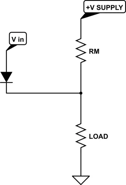

An even simpler, non-mathematical explanation (that does however involve "magic"):
schematic
V in is applied to the base. The cathode of the base "diode" is always about 0.7V lower than the base. However base current will always be much lower than the current in the load resistor, because RM is a "magic" resistor that adjusts itself to create the current gain of the circuit, which is very roughly the hfe of the transistor.
Basically, it is an amplifier with lots of current gain, unity voltage gain (i.e. no voltage gain), that also shifts the input signal by about 0.7V.
Oh, and it can only source current, never sink it of course.

  • +1 for the original explanation of the emitter follower. It is also interesting that the "magic resistor" (the collector-emitter junction) originally behaves as a current source but here it is forced by the negative feedback to behave as a voltage source. Figuratively speaking, RM and LOAD form a "magic voltage divider" that adjusts its output voltage equal to the input voltage. – Circuit fantasist Dec 02 '19 at 15:07

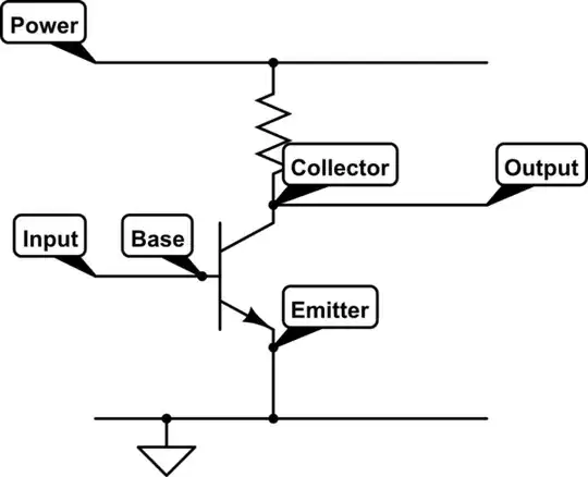

Very simple non-mathematical description (see comments below for all the bits I missed out).
With nothing on the Base (input) you just have the Collector (top) connected to the power rail and the Emitter (bottom) connected to ground.
Recall that the Base-Emitter and Base-Collector junctions are like diodes. In this configuration, the Base-Collector "diode" is reverse-biased so it looks like an open circuit and no current flows. The Output is therefore at the same voltage as the power rail.
When you put a small positive voltage on the input, the Base-Emitter junction becomes forward-biased and current starts to flow.
The injection of charge-carriers into the Base region modifies the characteristics of the Base-Collector junction in such a way that it allows current to flow from the Collector to the Emitter. So what was once an open-circuit (collector -> emitter) becomes a partial conductor whose resistance depends on the current injected at the base.
Current flowing in at the Collector pulls the output level low. The extent of the swing depends on the current at the base (this is the amplification effect).
Of course, a transistor is really a dynamic component so if you have an oscillating signal (e.g. from a guitar pickup) at the input, you will get a similar oscillation in the output voltage. Since this output voltage is coming from the power rail, it can have as much power as you like - enough to drive a speaker, for example.
