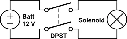

I have this 12V DPST switch that I want to wire, to make or break both Negative and Positive cable to open or close a solenoid valve.
I would say:
3. (+) to battery
4. (-) to battery
2. (+) to load
1. (-) to load
Is that correct? Anything that I should know?

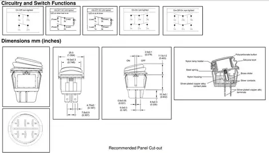

There does't seem to be a datasheet for this switch, but this is from a similar product from ZF that illustrates the arrangement.
The LED in the rocker body is connected to the contact plates by the springs and plungers that bear on the top of them. Whether you want to have the switch lit all the time or when the circuit is powered determines whether you connect the incoming power to the center terminals (second circuit from left), or to the right hand terminals - third circuit - respectively.
The arrangement of the terminals in the base is always the same, with the ones at the center being the fulcrum for the contact plate to pivot over. The empty positions on your switch are or the double throw versions. The blade along the center of the body separates the terminals of opposite polarity, and there's a wall inside the body that isolates the moving contacts.
What may not be the same is the polarity of the LED, which will obviously only illuminate with the right polarity applied. You may have to swap terminals 3 and 4 to get the LED to illuminate.
