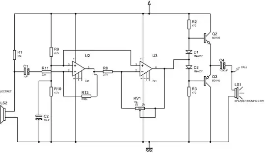

I have a project to build an intercom using op amp 741, because it is easy to find and is the only one that currently has access because of my location. Below the schematic diagram which I designed. The problem is that I can not solve a noise in the output like a noise of 60Hz, example of the noise: "tummmmmm" (audio link below on the website of vocaroo), this noise is so direct, even adjusting the gain with a potentiometer in step 1, the 330k ohm R13 resistor or in volume step 2 in the 10k RV1 resistor. Note: I tried to increase the power resistor of the electret is still continues. This amplifier will be outside and the microphone will be wired at a distance of + - 80/100 meters. The diagram is attached below. Has anyone ever experienced this? Or do you know how you know how to solve this problem with this noise? Thanks in advance!. https://vocaroo.com/i/s0jIWlJ8e3Yy enter image description here

  • How is it powered? – Colin Nov 13 '19 at 13:08
  • It is powered by a 127/220V-14V transformer, rectified by a 1n4007 diode bridge, as soon as the filtrate passes through a 1000uf 50V input capacitor then goes to an lm7812 and at the output has a 1000uf 50V capacitor. – gabriel Nov 13 '19 at 13:15
    hmmmm you've got grid frequency in your audio, and you've simply got a bridge rectifier feeding a really old linear voltage regulator with very little noise suppression abilities... – Marcus Müller Nov 13 '19 at 13:58
  • hi, which regulator would you suggest for this application – gabriel Nov 13 '19 at 14:10
    I'm surprised the 741 is the easiest op amp to find anywhere in the world, at this point. – Scott Seidman Nov 13 '19 at 14:22
  • @ScottSeidman If "location" is the limiting factor, this might be one of a couple million "standard" components imported in some bigger shipment that didn't fall under embargo rules one way or another. – Marcus Müller Nov 13 '19 at 14:30
  • Where/how is DC, earth gnd, mic and speaker supplied ? Is this a 4 wire interface? 5? 3?? what wire ? CAT3, CAT5 ? CAT1?? – Tony Stewart EE75 Nov 13 '19 at 14:41
    Note that the minimum supply voltage for the 741 is +/-10 V, and you're effectively giving it only +/-6 V. – Dave Tweed Nov 13 '19 at 15:05
  • Tony, the used cable and cat 5 – gabriel Nov 13 '19 at 15:25
  • Dave, I'm turning on the non-symmetrical 12V circuit – gabriel Nov 13 '19 at 15:27

  • "the same circuit with all short cable keeps generating the "huum" at the same amplitude? What happens to the noise if you disconnect the mic from the amplifier input and replace it with a 10k resistor? Is the ground in your circuit connected to mains earth? – Bruce Abbott Nov 13 '19 at 17:54
  • Just put in some extra effort and get some TLE2072's. You may also want to consider increasing your 4.7K bias resistors (R9 and R10) to 10K or even 100K ohms. Also, considering taking the feedback for the output amplifier from right before C4. –  Nov 14 '19 at 03:33

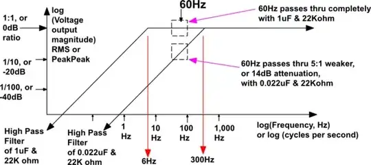

C1 and R11 are a high-pass filter. The RC time constant is 1uF * 22kohm = 22 millisecond. The F3dB = 1/(2 * PI * RC) = 0.16 * 45 = 6Hz.
You can reduce the capacitor to 0.022 uF, which raises the F3dB to 300Hz and will attenuate the 60Hz by 300/60 = 5:1 or 14dB. This reduction will be quite audible (each 3dB is audible; 4 factors of 3dB will please you).
If your interference is full-wave-rectifier sourced, then the 120 Hz ripple (2X faster) is attenuated by 14-6 = 8dB.

  • Thanks for the explanation, I will test as you suggested by lowering the capacitor to 22nf. – gabriel Nov 13 '19 at 15:15

  • Hello, I solved the problem by changing the resistor R11 to 470 ohms, placing a 100nF capacitor on the U3 output after feedback, switching the 220V / 127V ~ 14V linear power supply to a 12V switched computer power supply. Everything indicates that the noise came from the 120Hz rectification. – gabriel Nov 14 '19 at 15:03
  • so you increased the gain 40X (22K / 470) , heavily loaded the midpoint of the diode biasing with a cap, and changed to a different power supply. – analogsystemsrf Nov 14 '19 at 15:49
