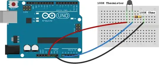

  • @Elliot Alderson I am not really too experienced with drawing circuits, but I attached an image, does this help? – Aditya Kendre Nov 02 '19 at 15:37
    @AdityaKendre an actual schematic would've been better (drawing them is not hard) than a wiring cartoon, but well, it helps, if you tell us which cables go where. – Marcus Müller Nov 02 '19 at 15:43
  • 5V got to the left side of the thermistor, GND has a 100k resistor that is connected to the right side of the thermistor. That same side has a wire that carries the analog signal to the Arduino. – Aditya Kendre Nov 02 '19 at 16:01
  • Are you familiar with a voltage divider? Consider what happens when the NTC is on the high side of the divider. – sstobbe Nov 02 '19 at 16:08

As general troubleshooting guide, if you question the thermistor, test it in isolation. Disconnect the thermistor from the circuit, and use a multimeter in resistance mode to measure its resistance... should show about 100 kohm. Grab the thermistor with your fingers to heat it, and verify that the resistance decreases. Then it's a NTC.
If the problem is not with the thermistor, it's the calculations. Your calculations don't look right to me but I can't say exactly what's wrong. You can't measure Vref as that's already the reference the ADC measures again -- it's like using a ruler to measure the length of the ruler.
As your thermistor is on the high side of the voltage divider and you measure across the lower resistor, you will measure higher voltage when a NTC thermistor heats up. Maybe this is what confuses you.
A warning about your setup; your voltage divider using a 100 kohm thermistor and 100 kohm resistor will together give 50 kohm impedance. Signal impedance is the resistance 'experienced' by the microcontroller ADC, or loosely how sensitive the signal is to disturbances. Arduino Uno uses the ATMega328 microcontroller, which needs lower impedance for ADC to avoid skewed measurements. The datasheet can tell you in detail but I vaguely remember it should be lower than 10 kohm at least. The easiest solution is to add a capacitor between A0 and GND. Any capacitor value 10 nF or higher is ok -- 100 nF and 1 uF are common values.
