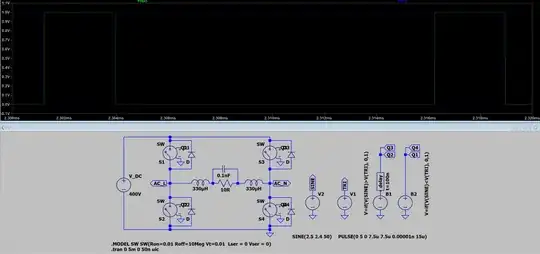

I am trying to generate a dead time between two switching legs in the conventional full bridge inverter. However, by simply including the delay block for one pair of switches - just shifts the signal with the same duty ratio, resulting in cross conduction for the following sub interval. The duty ratio is generated by comparing the saw tooth signal against the reference sine wave. enter image description here
Any suggestions how to generate pulses without cross over? Thanks in advance.
UPDATE
I implemented dead time with the proposed RC and Differential Schmitt block. However, decided to stick with the DS. I have been trying to understand this very hard, but still no idea if the dead time is actually doing anything or not? From the graph below (top right) you can see how both pairs of switches are cross conducting even though drive signal clearly has a specified dead time (below). I also varied some of the SW parameters, but didn't see much of a difference apart from more graduate, softer transitions. Any idea if I should dwell on this further or can I just assume that they are "successfully" driven with a dead time?enter image description here

  • As it is you have a 100 ns dead-time (glad you found the schematic helpful). If you need to check whether there is some, plot the gate signals. If you're plotting the voltages in the bridge (as I presume you did, since I can't know where your V(n002) is, if you don't label it) then you may get "cheated" by the uneven switching characteristic of the MOSFETs (the voltages and currents don't switch like an ideal switch, there are delays due to the physycal properties). – a concerned citizen Dec 09 '22 at 21:29

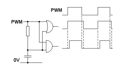

Duty cycle shortener (winny's suggested name): -
The lower waveform in the picture above can be used for top-left and bottom-right switches. An inverted version of the middle waveform (use a NAND gate instead) can be used to activate top-right and bottom-left switches.
  • Choose logic gates that have schmitt trigger inputs.
  • Choose RC to give appropriate time delay in line with schmitt trigger input levels.

    Perhaps I should trademark it! :-) – winny Oct 29 '19 at 16:25
  • Thanks to both of you. However, I can not find AND or NAND with Schmitt trigger inputs. I can use a Schmitt-triggered buffer though, right? – Rr Bb Oct 29 '19 at 16:36
    74xx132 springs to mind – Andy aka Oct 29 '19 at 17:12

    It seems to me that you should have generated a new question because this new question seems to stand on its own and personally, I hate evolving questions and resist answering them unless they are quite related to the original. This isn't as far as I can tell and also, there could be a mess of answers such as mine answering the first question and somebody answering the second question and which answer would you choose to formally accept? HINT - look at the currents in the MOSFETs to inspect dead time. – Andy aka Oct 30 '19 at 14:13
  • @Andyaka Thank you for coming back to me with this message. The switch current waveform is a good indication to what is happening! – Rr Bb Oct 30 '19 at 14:37
I know that the post have been since quite long-time, but I came here during my search for a behavioral modelling for dead-time, such that I would avoid using spice models of gate-drivers which would slow down my test. However, I see that you already did it and your model works well. You were wondering why you cannot see the effect of dead-time because actually you have been looking at the wrong thing. Your waveform shown is just a measure of VDS of Q1 and Q2(I assume this because I don't know what is net N002, I assume it's the input DC source). You cannot examine the effect of dead-time using only VDS, because dead-time is used to prevent the shoot-through problem when you have two series MOSFETs turned ON at same time which open a path for huge current to flow from DC source to GND. You would have been able to examine the dead-time effect by showing the current going through S1 & S2, also during the dead-time the current goes through D1 or D2!
Anyway, I am including the waveform of my full-bridge circuit that does have dead-time, but there is no shoot-through current. Waveform for voltage and current in Q1 & Q2 in a full-bridge converter
