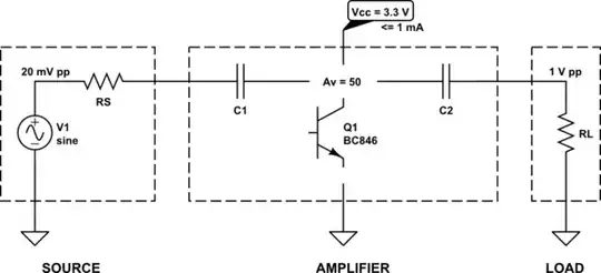

I'm trying to amplify a 20mV ptp signal to something around 1V ptp. I intent on only doing this in one stage and require the amplifier to be very low power consumption (3.3V supply max 1mA for entire amplifier). I'm trying to choose a bias point to operate the device at that will give a low enough power consumption and still give me the optimal gain I'm looking for. Drawing a load line on the BC846 NPN BJT I get a Q point that is very hard to achieve: enter image description here
I was wondering what characteristics I am looking for in a BJT that would give a lower current bias point.

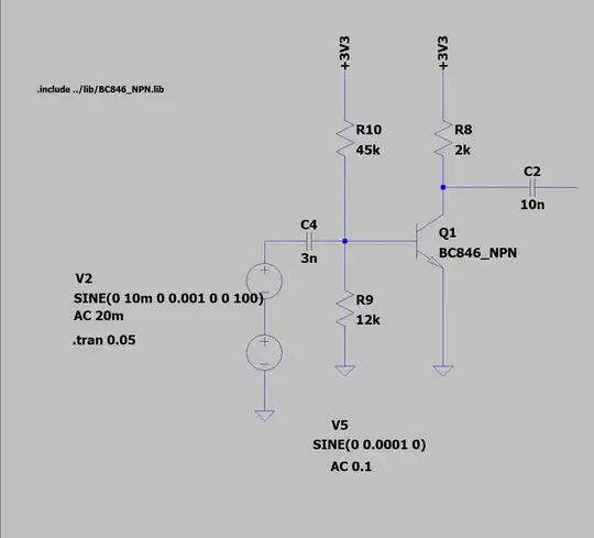

My current amp design: enter image description here
The bandwidth is only 100kHz.
Source impedance is ~5k purely real and load impedance is 100k real.

  • You have choosen Rc=2kOhm, so in a homework context your next task is to bias Q1 for an Ic=625 uA yielding a gm of $\approx 25$ mA/V. – sstobbe Oct 23 '19 at 15:50
  • with 4mvPP input, on grounded emitter, you'll have 10% distortion (if I recall rightly). With 20 mVpp, you'll have over 2:1 variation in gm (18mV is exactly 2:1), causing obvious POS versus NEG distortion of the SIN peaks. For grounded emitter and a passive Rcollector, the maximum gain you will achieve is VDD/0.026; in this case, 3.3/0.026 == 130 or so. A gain of 50 should be easy. I'd include a discrete Re, 51 ohms? to reduce distortion. – analogsystemsrf Oct 23 '19 at 17:52
    @analogsystemsrf Avoiding deep saturation of the BJT would probably mean (3.3-.6)/.026 or Avmax of about 100, not 130. We still have no idea what this thing is supposed to drive, nor what's driving it, nor what distortion can be tolerated. And there will be attenuation on both ends, whatever it is. I think the gain of 50 won't be a cakewalk. I suspect there will be some carefully crafted trade-offs to get to a realistic end point. – jonk Oct 24 '19 at 00:56
  • @analogsystemsrf Something else just crossed my mind to make this more difficult. That calculation of Avmax is based upon maximizing the gain on the positive-going half-cycle. But biasing a BJT towards the very edge of its saturation region doesn't allow room for the negative-going half-cycle. So it's now looking still tougher to me. I should have seen this before. But I'm just a hobbyist. Not a professional. So I miss the obvious, sometimes, and it takes time to drip through. Oh, well. – jonk Oct 24 '19 at 06:59
  • @Mack What's the frequency range for that bandwidth? Not because I think it matters for a single BJT amplifier like this, since the other requirements, so far, now appear to be unachievable. Also, how much distortion can you tolerate? (You could answer that, at least partly, by simply telling me the full, allowable range over which the voltage gain can move throughout one cycle at the input, I suppose.) – jonk Oct 25 '19 at 16:02

This is the circuit I think you are inquiring about:
schematic
As you can see, there are some specifications. But to be honest, not enough. No idea of \$R_\text{L}\$ or \$R_\text{S}\$ (which cannot be ignored), for example. Suppose \$R_\text{L}=3.3\:\text{k}\Omega\$? Then already you have \$\pm 1\:\text{mA pp}\$ as a compliance requirement for the output. And that's without the amplifier itself requiring anything at all to support itself. It brings up another question, too. Do you mean \$1\:\text{mA}\$ as the average current from your \$V_\text{CC}\$ supply rail? Or do you mean \$1\:\text{mA}\$ as the worst case peak value? Not specified. Yet it probably is important to know. I have no idea what the frequency is supposed to be (your schematic's AC supply says \$0\:\text{Hz}\$; but of course I'm sure that's not correct.) And no idea what the bandwidth should be, either.
Let me cut to the meat of things, though. Let's assume that you are willing to bias \$Q_1\$ in such a way that it sits just on the cusp of saturation -- say, where \$V_{\text{CE}_\text{MIN}}\approx 500-600\:\text{mV}\$. And let's also say that you are willing to have the collector voltage swing all the way to the \$V_\text{CC}\$ rail, as well. That's the absolute maximum possible collector swing. Then it follows that \$A_{v_\text{MAX}}=\frac{V_\text{CC}-V_{\text{CE}_\text{MIN}}}{V_T}\$ (assuming the usual emission coefficient of \$\eta=1\$.) At a maximum operating temperature of, say, \$50^\circ\text{ C}\$, \$V_T\approx 28\:\text{mV}\$. So this suggests \$A_{v_\text{MAX}}\approx 100\$.
That may sound good to you. But there's a problem. This only works with the BJT biased right at the very cusp of saturation. Which means that only one half-cycle of the input AC signal can be passed along. The other half-cycle is almost entirely clipped away, as it drives the BJT deeply towards saturation. And it ignores the huge distortion caused by widely varying gain for the half-cycle over which it does work.
Oh. Did I forget to mention that biasing the BJT to the very cusp of saturation, in the grounded emitter configuration you show, is quite temperature-dependent? Well, let me mention it now. That's another problem. Not much thermal stability. Even assuming you could accept its other difficulties.
I'm almost certain that's unacceptable. Which means the above calculation of \$A_{v_\text{MAX}}\$ is grossly overly optimistic. So now it seems that there may be some difficulties achieving your voltage gain goals, even temporarily ignoring the rest of the information you've failed to provide.
I have tried here to illustrate what's missing in the information you've provided and pointed you towards the singularly glaring difficulty in achieving a high voltage gain with a relatively low \$V_\text{CC}\$. I've also pointed out that there will be a great deal of distortion involved when pushing this to its limits. And I've added that all of those factors will also be temperature-dependent, which means the circuit will do different things in different seasons or areas of the world.
So you need to clarify the temperature range over which this circuit must operate, how much ripple or allowable variances there might be in \$V_\text{CC}\$, whether or not the \$1\:\text{mA}\$ current limitation is average or peak, the bandwidth required over which it must operate within these specs, the load and source impedances, etc. There's a lot missing in this. I don't see how anyone can help you without writing an entire textbook along with a set of course study materials and lesson plans.
