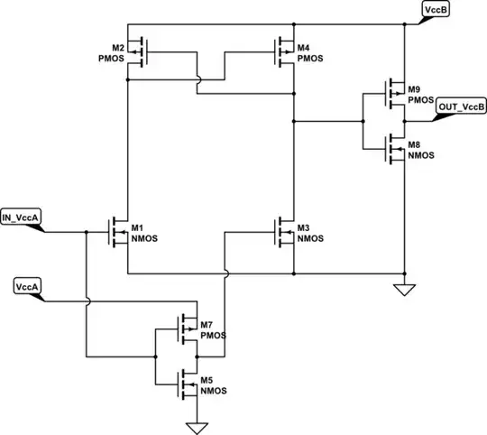

Allow me to share with you the circuit of a levelshifter as is used in many ICs:
schematic
It uses 8 transistors, which looks like a lot.
But this is what is used on a chip so transistors can be made extremely small. On a chip this can be made to work up to GHz frequencies. When static (the input signal does not change) the circuit consumes no current.
It is nearly impossible to build this circuit on a PCB using discrete MOSFETs and get similar performance, you'll be lucky to make it work at 10 MHz. Discrete MOSFETs aren't designed to be used like this.
Fortunately chip manufacturers put this circuit (or something similar) on a chip for you to use. Just search for "levelshifter" and you should find a suitable chip to do the job.

  • Thank you, Spice confirms that this is an effective solution and its exactly what I'm looking for. I only need 1MHz and there are some small dual N/P mosfet packages which I can fit 4 of in the space available. – Charlie Skilbeck Oct 23 '19 at 09:32
    Indeed this might work at 1 MHz with small dual N/P mosfets in a package. Before committing this to a PCB I would add a precaution to be able to make M2 and M4 "weaker". This can be needed to allow M2 and M4 to "flip" under all conditions. To make M2 and M4 weaker, add a series resistor between their sources and the VccB rail. Just put 0 ohm to start and if you have issues, try a higher value. – Bimpelrekkie Oct 23 '19 at 09:37
