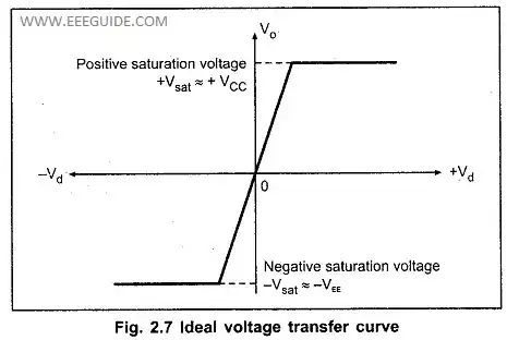

Precisely, I have been always told that an operational amplifier with negative feedback works in linear region, i.e. that with the diagonal straight line in the following picture:
Now I always saw this reasoning: since the negative feedback forces the op-Amp in the linear region we may write that A = Vout/(V+-V-). Now, since A is very high, ideally infinite, we get that (V+ - V-) = Vout/A = 0. This property is called virtual short between op-Amp input terminals.
My question does not regards this last step (which I saw also in many topics here) but the sentence "the negative feedback forces the op-Amp in the linear region": why? Why does the connection of the output terminal to the inverting input terminal determine this condition? I think that probably I should know the internal structure of an op-Amp to understand it correctly, but can you give me a brief explanation?

  • There are many straight lines in your picture. – Andy aka Oct 16 '19 at 13:57
  • Sorry, I will correct the sentence – Kinka-Byo Oct 16 '19 at 14:00

If \$V_+ = V_-\$ then, by definition, \$V_D = 0\$. If you look at the transfer curve you included in your answer, the region of operation where \$V_D =0 \$ is at the center of the graph. In this region, the output voltage is a linear function of \$V_D\$. Specifically, \$V_O = A_{OL}\times V_D\$.
EDIT: To clarify based on the comments, the output voltage of the op amp must be maintained within its specified linear range to maintain negative feedback. If the op amp saturates then it is no longer linear. Negative feedback does not guarantee linear operation, but the assumption that \$V_+ = V_-\$ is predicated on the presence of negative feedback.

  • This reasoning expresses the fact that VD = 0 means linear region, and it is visible from the graph. But my doubt is about how the negative feedback guarantees that the Op - Amp will work in the linear region (and not in saturation, where it is not true that Vo = A × VD) – Kinka-Byo Oct 16 '19 at 14:09
