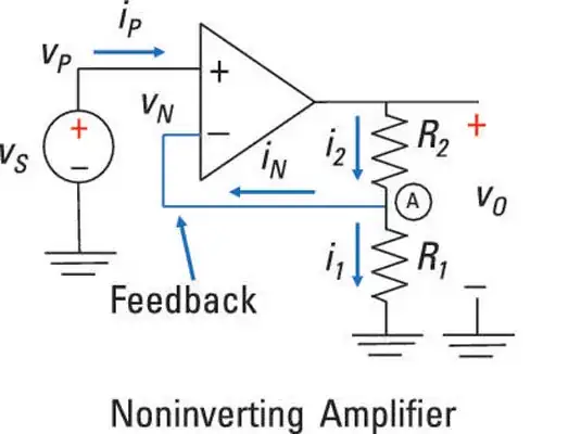

The concept of a 'virtual short' is not complete without understanding feedback. An opamp without feedback cannot maintain a virtual ground.
In the picture below, Vp is equalized with Vn only through the output changing. If Vn is greater than Vp then the output will be adjusted down until Vp and Vn are equal (and vice versa if Vp is greater than Vn).
Very little current actually goes into the terminals, the terminals are high impedance in many modern opamps the current into the terminals is less than 1uA and sometimes in the pA range, in most cases, the current flowing into the terminals can be neglected because it is so small.
The current that does make a difference in changing the terminals value is the current from the output.
Source: https://www.dummies.com/education/science/science-electronics/analyze-noninverting-op-amp-circuits/

  • Specifically, it is negative feedback that is required to create the virtual short. As shown in your example, the effect is better called a "virtual short" than a "virtual ground"...neither of the inputs is at ground. – Elliot Alderson Oct 15 '19 at 18:25
  • I've seen one amp that does not require negative feedback itself (but the outer loop does) – Voltage Spike Oct 15 '19 at 18:26
