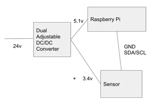

Due to the manufacturer's advice, I want to test the sensor at 3.4v. The RPi is being powered from a dual adjustable buck converter, so I decided to set the 2nd output to 3.4v and connect GND and 3.4v directly from the converter to the sensor, and only connect SDA/SCL from the sensor to the RPi. I got a lot of communication issues from the software, and I found that the voltage was reading a little bit different than expected. I decided (possibly incorrectly) that this was due to floating grounds*, so I then wired the sensor's ground to the RPi and only the + 3.4v from the converter. The setup looks like this:

When the sensor is wired directly to the Pi, including power and ground, the SDA signal looks reasonably straight with perpendicular lines and 90degree angles.
When I had the sensor Vdd wired to the buck's power output the SDA line was a bit sloppier. Less 90 degree angles, and an occasional blip. For what it's worth, Vdd looked stable on the scope.
I thought that maybe the cable I built to connect the sensor to both the RPi and the power supply might be bad, so I then disconnected the +3.4v wire from the buck converter and connected it directly to the RPi's 3.3v pin. After doing this the SDA signal looked clean again.
FWIW, the sensor has configurable pull-ups. I normally keep them disabled because the RPi has its own, but after seeing the SDA signal I tried enabling the sensor's pull-ups and it didn't make a difference.
So, what could be causing the sloppy SDA signal? How do I address it? My long-term plan is to send 5V to the sensor board and then use an LDO to convert to 3.4v. Will this approach solve the problem I'm seeing?
*I measured a voltage difference between the Buck's output ground and the Pi's ground somewhere around 50mv.
