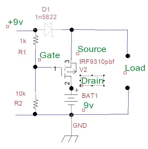

EDIT: I have shown my problem in the rough diagrams below (sorry if the symbols are not accurate).
Works but battery powers load through internal diode (apparently): circuit works
Even though above circuit works, the question is about the internal resistance of diode and the drop across the mosfet when main power is off.
Following does not work because main voltage shows up at battery connector:
circuit does not work
In the above circuit, I expect the mosfet not to conduct when there is +9v. But it is conducting because of the internal diode. This circuit would take advantage of the low Rds(on), so it is desired.
When there is no +9v, the load gets powered by the battery alright.

  • @RussellMcMahon I am able to get it working if I reverse Drain and Source in the above circuit. But my worry is about the forward resistance of the internal diode, which will affect my backup time, and hence the original question. – Arundale Ramanathan Oct 03 '19 at 11:54
  • @RussellMcMahon In your solution with two mosfets in series, will it have Rds(on) as low as around 10mOhms as that of one mosfet? I guess Rds(on) is what affects voltage drop. – Arundale Ramanathan Oct 03 '19 at 12:04

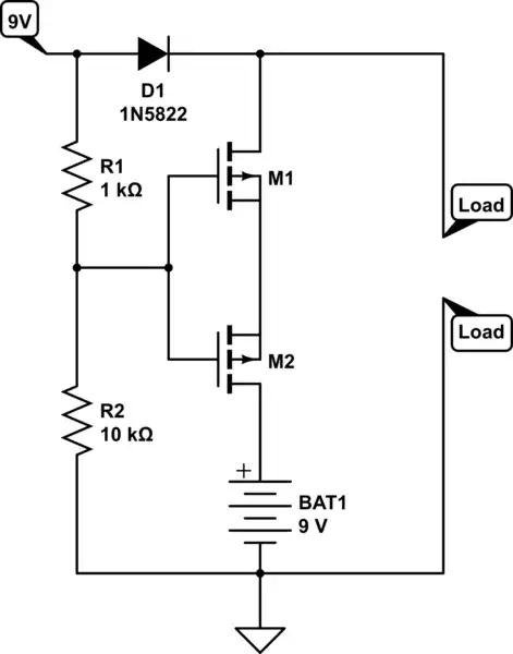

I answer to your questions below, starting from the first one on the body drain diode.
  • What would be the internal resistance of this diode? Will it be the same as Rds(on)? I can't seem to find it in the datasheet.
The I-V characteristic of a diode is not linear, so it is almost never modeled as a single resistor: this is the reason why, in the datasheet of the MOSFETS you use, such parameter is not even mentioned. The only exception to this situation I'm aware of is the characterization of high power diodes like this: in the datasheet of those power devices, the so called slope resistance \$\mathrm{r_T}\$ is specified. In such devices, the magnitude of this model resistance is usually of few milliohms: however, in MOSFETs you cannot expect any precise relation between the (unspecified) \$\mathrm{r_T}\$ and the (very well characterized) \$R_{DS_\mathrm{ON}}\$ since these two resistances do not model the same physical phenomena even if the semiconductor structure is the very same one.
  • Do you know of any P-channel mosfet that does not have this diode but has similar Rds(on) (10 to 15 mOhms at -4.5v?). I do not want reverse current to flow in a particular case, as I need my switching to work in only one direction.
Power MOSFETs where the body drain diode is not present have been produced in the past, but they are not easily available and surely do not have the low \$R_{DS_\mathrm{ON}}\$ you need in your application. I suggest another approach which may be a more viable alternative:
schematic
The \$p\$-channel MOSFETs shown are used in the so called anti series connection: when the common \$V_{GS}\$ is \$>0\$, the MOSFETs are OFF and the two body drain diodes are connected back to back, so they are not conducting. When \$V_{GS}\ll V_\mathrm{th}\$, both the two MOSFETs are ON and the battery feed the load through a \$2R_{DS_\mathrm{ON}}\$ resistance: by choosing properly the devices, you solve the problem at the cost of an additional MOSFET.

    That circuit will not work properly because the FETs will stay turned on when 9V is applied. The OPs circuit partially gets around this by using a small value for R1 which reduces Gate voltage, but this causes high FET voltage drop in battery mode. The proper solution is an 'ideal diode' circuit https://electronics.stackexchange.com/questions/223935/understanding-an-ideal-diode-made-from-a-p-channel-mosfet-and-pnp-transistors – Bruce Abbott Oct 04 '19 at 03:20
    @BruceAbbott correct. I just substituted the $p$-MOS switch in the above circuit by other two antiseries connected switches: some work may be needed in order to make this circuit properly and a wired (ideal, made as shown in your link) diode resistor OR circuit may be the right choice in this application. – Daniele Tampieri Oct 04 '19 at 05:53
    @BruceAbbott In my actual circuit, I have this 1n5822 to prevent the situation you have mentioned.. I have updated the question.. It does have a huge drop, but its ok on the main power as anyway input is a bit higher than 9v and efficiency is not that important on main power. The solution you have pointed to is above my head. – Arundale Ramanathan Oct 04 '19 at 06:30
    With the diode it works, and as a bonus you don't need the extra FET! Since the primary battery can't stand any charge current I would make R1 a bit lower (eg. 220 Ohms) to ensure Gate voltage is well below the threshold with higher input voltage. – Bruce Abbott Oct 04 '19 at 08:38
  • @BruceAbbott I am not sure if I get what you propose.. I did try with R1=0, R2=10k but still read +9v on the battery connector with the battery removed and main power on. I guess this was because of the internal diode. – Arundale Ramanathan Oct 04 '19 at 08:45
    With R1 = zero ohms the FET should get reverse bias (ie. Gate more positive than Source) and be fully off, but will have some leakage which might be enough to show a voltage reading on your meter (eg. IRF9310 has max leakage of 1uA, 10M input multimeter only needs 0.9uA to read 9V). To check that FET is turning off properly, measure current between FET and battery. Make sure FET is wired with Drain to battery and Source to load. – Bruce Abbott Oct 04 '19 at 09:02
  • "Make sure FET is wired with Drain to battery and Source to load" - This already works I know. Because the FET is turned off when main power is on. When main power is off, the battery powers the load through the Internal diode and thats why my original question about the internal resistance and drop across it. The above circuit is not wired "Drain to battery and Source to load". It is wired other way round to take advantage of the low Rds(on) when powered through battery. – Arundale Ramanathan Oct 04 '19 at 10:51
