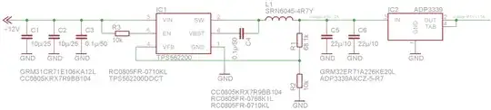

Following my question Powering up analog part of the video card (thanks everyone for their inputs and advices) I have chosen the devices, and even have drawn the circuit diagram of 12 V to 5 V power converter:
Output current is expected to be approx 250 mA, maximum 500 mA.

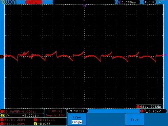

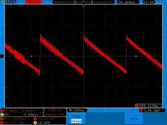

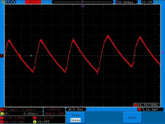

Article considers this case with very demonstrative pictures:
enter image description here Above is an output for the "nominal" operating conditions.
enter image description here Above is an output for the 200 mA supply current. Ripple frequency is 65 kHz.
enter image description here Above is an output for the 50 mA supply current. Ripple frequency is 1.2 kHz.
This noise would be a huge issue for the analog circuits. I see two ways to deal with it:
  1. change regulator with one rated for smaller current - for example, TPS560200, then "The transition point to the light load operation" will happen at 230 mA. However I suspect most of the times less current will be consumed from the supply, and it may easily happen that switcher will work in this featured ecomode.
  2. Keep this ADP3339 High Accuracy, Ultralow IQ, 1.5 A, anyCAP Low Dropout Regulator. It has very nice ripple rejection property:
and this ripple under 100 kHz is expected to be attenuated greatly.
Questions:
Is this ripple effect will take place under "lighter" loads for any switcher, or it is a "feature" of these TPS ones?
Do you think the design is acceptable for powering analog video circuits - would selected LDO cure the issue created by the TPS?
Maybe you can propose something better than I have drafted?

The light load efficiency mode (PFM) greatly improves the efficiency in the range where it's operational, at the expense of higher ripple and variable switching frequency.
It's a hysteretic mode, so frequency depends on the load current.
There are other parts from TI and other manufacturers that are PWM only, or selectable between forced PWM and auto-PWM/PFM modes. One of those may be more appropriate if you're not concerned about the efficiency loss.
One example is the TPS562208, though a smaller device could be used based on your load requirements.
If you want to keep the switcher as-is, (for efficiency or convenience) the LDO will certainly help, but be sure you have enough headroom above the dropout voltage to get the PSRR you need. As you approach dropout, the PSRR will fall off rapidly. The datasheet doesn't do a good job of specifying this, so you may need to experiment.
