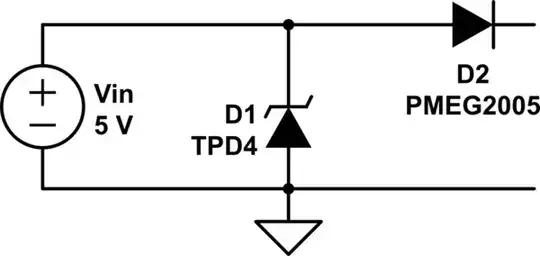

I need to protect an external input on a device against both reverse polarity and ESD (IEC61000-4-2 +-8kV). The normal input is +5V dc at 100-200mA; the reversed input could be -5V and that should be blocked (maybe with a few uA leakage).
I tried to design this using a TVS device (TI TPD3 or TPD4 series) and a low Vf Schottky diode (PMEG2005 or similar). The problem is that whichever device is put first would be damaged by the condition that the other one protects against.
Option A: TVS first
schematic
Reverse polarity would damage the TVS - it is definitely not rated to have an input go below ground-0.3V, especially not one with decently high current.

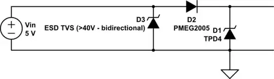

If the idea is to protect the diode, one could put a TVS diode with a voltage much higher than anything that might be put on the inputs, like something that would clamp more than 40 or 100V. There are many TVS diodes built specifically for handling ESD and have much higher 'knee' voltages. The diode would not turn on if the polarity were reversed, but would turn on during an ESD event. This would protect the reverse polarity diode.
schematic

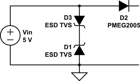

To prevent the TVS will be damaged due to reverse polarity, just add another TVS in anti-series.
schematic
D1 should be rated with respect to the maximum correct applied voltage.
D3 should be rated with respect to the maximum (expected) reversed applied voltage.
(In OP "the reversed input could be -5V", so, D1 and D3 can be the same components).
  • In case of ESD, one TVS will be forward biased and the other TVS will clamp.
  • In case of reverse polarity D3 will protect D1.
    D2 will protect the rest of the circuit.
Huisman
  • 10,694
  • 20
  • 40
  • I think this is the canonical answer to this type of problem. Antiseries TVS diodes are made as single devices as well. Nice! – Alex I Nov 15 '19 at 02:46
