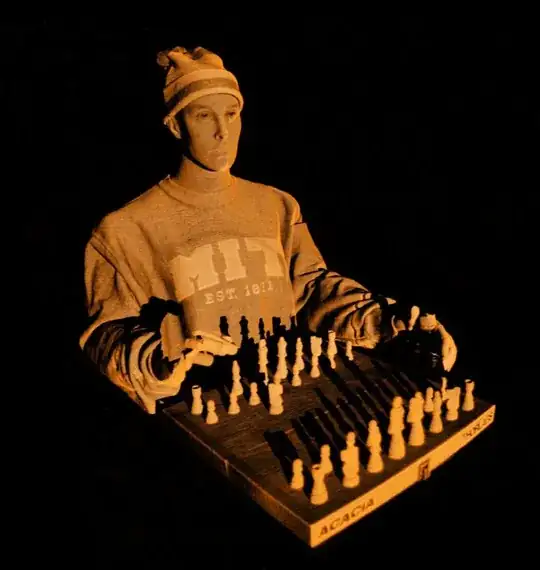

To demonstrate what can be done with coherent detection, here is a Fourier domain LIDAR image from an OCT system:
This system used a 1310nm laser that could be tuned continuously over 110nm of bandwidth (or a bit more if you pushed it), giving a resolution when ranging of 10 microns. The very high bandwidth (~20 THz) enables resolution approximately 1000 times higher than the electronic bandwidth would allow. That said, that image has so many voxels (over 200 billion) that the resolution had to be decreased (by setting the laser to span a narrower bandwidth than it was cable of) to speed up acquisition.

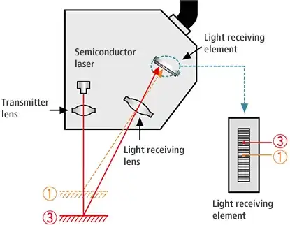

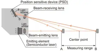

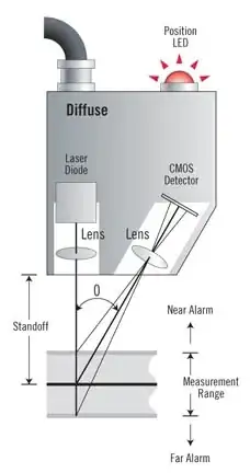

I'm going to respectfully disagree with both of the previous answers above.
They accurately describe conventional monochromatic interferometry which can measure velocity and relative position with incredible accuracy, but cannot measure absolute range and so are not used in LIDAR. A dual (or triple, or N) wavelength system extends the range before you hit the ambiguity, but still cannot unambiguously return the true distance until you hit the low coherence case of a continuous, broadband spectrum. Similarly, a displacement sensor is not based on time of flight, but is instead a type of confocal sensor that uses a wide numerical aperture to look at the spatial divergence of light to infer distance. Both of these technologies are alternatives to high resolution LIDAR, rather than how high resolution LIDAR is implemented.
