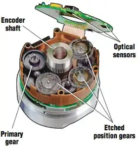

Manufacturers choose different strategies about absolute encoders. Asian and Japan manufacturers tend to use kind of incremental encoder that needs an additional lithium battery at driver side to power the encoder at power outage.
European manufacturers usually use hall sensors with magnet gears, similarly like a water counter for counting revolutions, while the disc is made of glass or it's a resolver - this is so called multiturn absolute encoder. Disc or resolver gives the position within one revolution, while the gearbox measures numbers of revolutions. Such encoders don't need power for counting position. However an EEPROM inside is a good to have, used to store reference or null position.
Encoder Gears
I had used Sick, Kuebler, Indramat,...I can confirm it does not need power. While Fanuc has an additional battery in motor driver.

  • Such encoders don't need power for counting position. Do you mean, there are self-powered or not using power at all? – Huisman Sep 26 '19 at 06:44
  • They are not self powered, they just do nothing when powered off, but once powered on they send the true position even if they were moved while powered off. – Marko Buršič Sep 26 '19 at 06:56
  • @Marko Buršič Just to confirm for both the Asian-style (with battery) and European-style encoders (with gears): if the encoder's position AND number of revolutions was changed while the encoder was powered off, will the encoder be able to remember these two values once it is turned on again? – Cherry Sep 26 '19 at 07:25
  • As OEM integrator I can confirm that Sick encoder would do this. As a CNC service, I can only say that disconnecting a Fanuc encoder or battery drain it will loose the position. Those battery powered are rather proprietary, never used as OEM. What is your project? – Marko Buršič Sep 26 '19 at 07:45
  • @Huisman - There are two different functions being performed - measurement and readout. The measurement function is self-powered, in that a very small amount of power is required to move the gears and this is provided by the shaft connection. The readout function is electronic/optical, and this requires external power to operate. So with no power the unit functions "normally", recording the current position of the shaft. When power is applied, the operation of the gears is unaffected, but their position is read out and reported. – WhatRoughBeast Sep 26 '19 at 14:24
