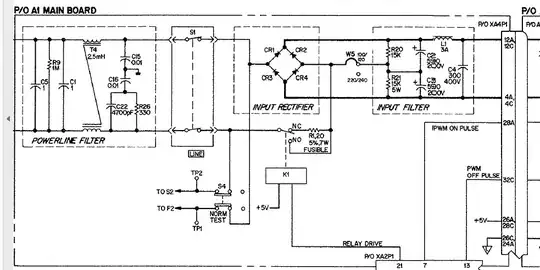

This is again from an HP power supply (PSU). The incoming 230 V is rectified into 340 VDC and is fed to a switched-mode supply. The odd thing here is that the manual for that unit, HP6023A, has different diodes for CR1, CR3, and CR2, CR4.
CR1 and CR3 are labeled "pwr rect 600V 3A 200ns" (MR856) whereas the other two are just "pwr rect 600V 3A" (1N5406). In reality the unit did have four identical MUR 460s which is indeed a 200 ns part. If we look at a more recent schematic for a similar PSU (HP6038) then they are labelled "1901-1199 diode-power rectifier 600V 3A":
Schematic
Now 1901-1199 is indeed MUR460 in real life. Is there a reason to use fast recovery diodes in a bridge for 50 or 60 Hz? Is it because it drives a switcher?

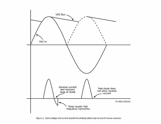

Here is a paper from Power Integrations which covers the comparison, from which the below graph was drawn:
Interestingly, the author says that it is sufficient that two of the diodes are fast-recovery.

    "Interestingly, the author says that it is sufficient that two of the diodes are fast-recovery." Interesting indeed. If one of the diodes shuts off then it doesn't matter if the other is slow. It's just a matter of making sure that one is covering positive half-cycles and the other the negative half-cycles. – Transistor Sep 25 '19 at 18:22

The fact that it drives a switcher doesn't mean too much, since even quick current pulses are smoothed out by the output filter (called "input filter" in the schematic), especially the series inductor L1, which will hold the current drawn from the bridge constant (ideally).
Most probably they already had such diodes in their bill of materials for other parts of the circuit. Perhaps the rectifier circuits after the switching transformer, where the AC power is high frequency and a fast diode is needed to minimize losses.
So it makes sense to optimize the BOM and reusing a part that must be already in stock.
