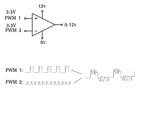

I need a suggestion how to sum two PWM signals, PWM 1 + PWM 2 to an output that have them both included.
Questions:
  1. Is this possible? Other suggestions?
  2. What Op Amp do I need to use if I want the output handle heavy load of 12 volt? I'm going to control a large 12 DC motor and the small frequency PWM 2 is going to be the dither signal to make sure that the 12 DC motor is still in a vibrating movement. It reduces friction and makes the 12 DC motor more linear and proportional to the PWM 1 signal.

  • Are the signals different magnitudes? Usually PWM is an On/Off signal at a logic level (3.3V or 5V typically), your "summed" PWM looks to have intermediate values which really isn't PWM anymore, since some of the high levels look to be less than half, and some of the upper levels not really falling to something the other side would consider "low". This may be an X-Y problem... what are you trying to solve? – Ron Beyer Sep 24 '19 at 12:02
  • I think you may have misunderstood something you've read. A sum like that would not work. You need to AND or maybe OR the two digital signals rather than adding the analog voltages. – JRE Sep 24 '19 at 12:04

  • @RonBeyer Yes. Different amplitudes. I made this picture with Paint. I want to include noise into PWM signals to control motors and spools. – euraad Sep 24 '19 at 12:30

  • "I have been controlling hydraulic with a PWM generator and these PWM generator have a tiny PWM generation included." I suspect what you really want to do is dither a high frequency PWM to create a lower frequency variation in the PWM ratio. https://electronics.stackexchange.com/questions/424082/could-someone-explain-dither-signal/424091 – Bruce Abbott Sep 24 '19 at 13:33
  • @BruceAbbott Yes. I want to make the main spool viberating inside the self-resontant area. – euraad Sep 24 '19 at 13:38

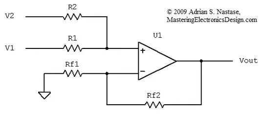

You could try a non inverting summing amplifier.
Non Inverting Summing Amplifier
https://masteringelectronicsdesign.com/the-transfer-function-of-the-summing-amplifier-with-n-input-signals/
You put your two input values on the (+) input. The link also provides the output equation as
If you make all the resistor values the same it should come out as Vout = V1+V2
