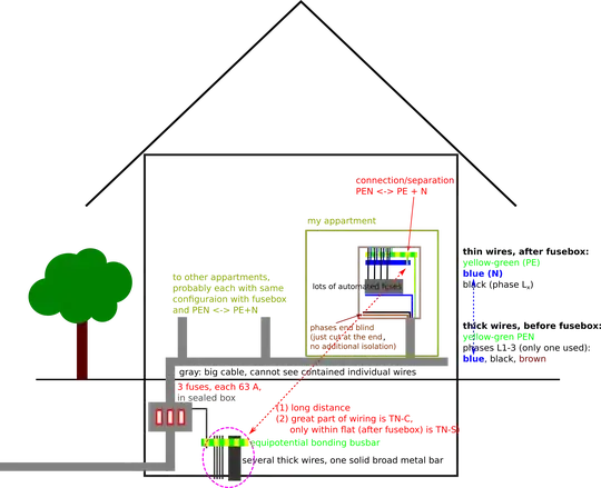

Schematic drawing: enter image description here

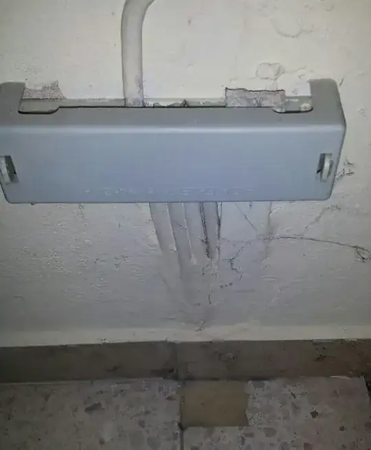

Photo of equipotential bonding busbar and wires (purple circle in drawing above). What are the 4 wires plus solid metal bar ging downwards? enter image description here

  • Thanks! This would help me a lot as answer if you could add a short note WHERE the PE/N separartion may/should occur, also regarding the (distance to) the earthing point. (situation became more complex, see edit, but does not matter for the question of where). – Martin Sep 08 '19 at 22:24
  • Anywhere, regardless of the distance. You should edit your question and add a circuit drawing ( it's just drawing lines in your case), I get lost while reading your description. – Marko Buršič Sep 09 '19 at 06:31
  • Added drawing as requested. If you say, the distance (and thus the amount of TN-C within house) does not matter, this would be the answer. Bonus Q: what are the 4 big wires plus the solid metal bar, going downwards from the equipotential bonding busbar to the floor (purple circle and photo)? Big one for earther, I guess. Others - to iron water pipes, additional earthers...? – Martin Sep 09 '19 at 21:27
  • Hi, nice presentation since last viewed. The wires connected to bussbar are earthing as you have already found out: water pipes, foundation earthing, ground rods,...It's done very good indeed, nothing differently compared to the distribution from street cabinet to housing, except there are other series connected flats. So the PEN comes from street cabinet->main house -> flats. Each house the PEN is then separated in PE and N, so never reconnected back again. – Marko Buršič Sep 19 '19 at 11:55
