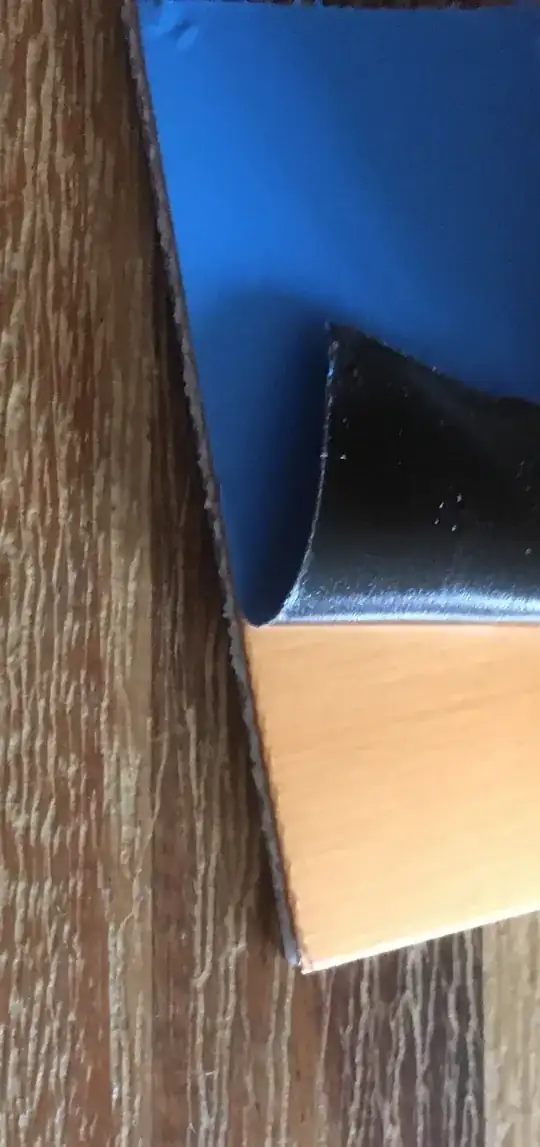

Edit2 Is it possible, that this black layer is the photo resist layer and should stay on the board when peeling the blue off? It is impossible to separate the blue and black layer, so this could be a fabrication mistake. enter image description here

  • Are you sure your blank pcb is photosensitive? Seems like it is not. You just have a plain normal blank copper pcb. Also with 500w the vendor says 6-7 minutes, not 2 minutes. – Soldersmoke Sep 05 '19 at 10:31
  • @Soldersmoke I use a 500W halogen lamp, which has more UV than usual bulbs. The vendor says 1000-W halogen bulbs: 45 - 70s – black Sep 05 '19 at 11:13
