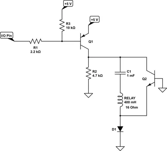

So let's assume you can succeed with your existing \$5\:\text{V}\$ rail. One circuit you can find on the web (for example, see OMRON: 6-10 Example of Power-saving Drive Circuit for Single-winding Latching Relay) could suggest something like this:
schematic
The above circuit, though, requires some careful tweaking of part values to carefully match up with the relay. Also, \$C_1\$ needs to be rather large and it, along with \$R_2\$, will need to be tinkered into the right values before this becomes anywhere close to reliable. I honestly don't believe this is the right approach for your valve relay, though. It requires way too much drive current for this idea to succeed.

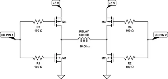

So this leaves us with the more obvious choice: an H-bridge. Perhaps something like this:
schematic
simulate this circuit
You may not actually require the indicated four resistors shown in the above circuit. They are there mostly to deal with HF oscillation. But given the drive impedance of your I/O pins, it's unlikely to be a problem. So you may consider simply removing the above resistors, bypassing them with wires, and be just fine. This makes for a very simple circuit.
(Well, it might. If you don't care about shoot-through, which can be a special problem with low-threshold mosfet H-bridge designs that are this simple. Adding analog circuitry to mitigate against shoot-through can be a pain and will add parts.)
Note that in the above schematic, you might start out with your Arduino having both I/O lines at LO or ground. Then, when you want to pulse the relay coil in one direction, you'd raise I/O 1 to HI and leave I/O 2 at LO for \$\ge 250\:\text{ms}\$, after which you'd raise I/O 2 to HI and leave it there until you wanted to change the relay. When you wanted to do that, just lower I/O 1 to LO, keeping I/O 2 at HI for \$\ge 250\:\text{ms}\$ (after which you'd lower I/O 2 to LO, again.) This would work okay, I think. (I've greatly increased the active-time in order to make sure sufficient time is allowed for the required drive current to arrive. You might tinker with this timing to get a faster response. But that's an experiment for you to perform.)

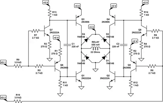

BJT-Only H-bridge
There are lots of ways to go with a BJT H-bridge. Just google them up and you'll see plenty. The one I'll provide won't be the first or second schematic you might find. But it may work okay for you:
schematic
The diodes provide a path for the relay coil to release its magnetic energy when it is turned off. The four BJTs nearest the relay coil are your h-bridge "switches" and they must provide up to about \$230\:\text{mA}\$ for the relay coil. This is well within the capability of small signal BJTs. (Please keep all wiring short and tight and you might also provide nearby power supply rail bypass capacitors -- not shown.) The other BJTs are added to provide the necessary base current. The resistors help manage all the details and allow the driver BJTs to avoid going into deep saturation (which isn't needed.) That's about it.
The above circuit also includes six more parts to deal with minimizing shoot-through, as well. So this is the much closer to a full design than the mosfet example above. But I think you can see a few more parts involved.
