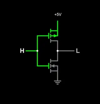

The two types are complementary. (The 'C' in CMOS means complementary, and in fact internally both P and N type are used throughout a CMOS IC.)
As a designer, which FET type you choose mostly depends on what you're switching.
As a rule:
- switching high-side signals, use PMOS
- switching low-side signals, use NMOS
Why? It's just easier when you consider how the gate voltages work:
- NMOS - Gate-source 'on' voltage is GND+Threshold ~ Vdd
- PMOS - Gate-source 'on' voltage is Vdd-Threshold ~ 0
So an NMOS is 'on' if its gate is at Vdd, PMOS is 'on' if gate is at GND. Wire the pair together, and you get an inverter (simulate it here):

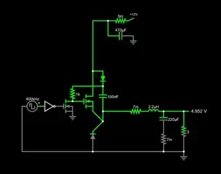

For higher-power stuff, it's sometimes preferable to use NMOS for high-side too: NMOS is more area efficient than PMOS for a given power handling capability. To do this NMOS-on-high-side party trick requires making a higher-than-high gate drive voltage, so that the NMOS will be fully turned 'on'.
This higher-than-high trick is used in switching power supplies for example: they use a 'bootstrap' circuit to make that higher gate voltage for the NMOS on high side. (Simulate it here):
Related: Buck Converter Simulation in OrCAD Capture Lite
