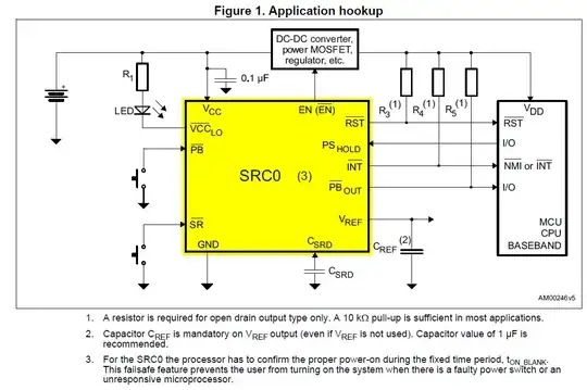

one from ST:

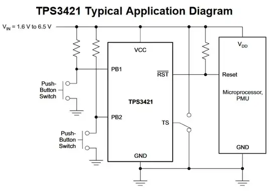

One from TI:

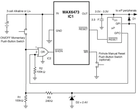

from Maxim (LDO plus logic)
