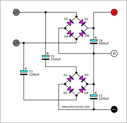

ac to dc dual power supply
This one works well but needs an AC power supply and high capacity and voltage capacitors and they take a lot of space but so far best I could find.

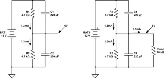

Virtual ground resistor circuit
This one looks simpler and doesn't need an AC source or big capacitors but either I can't understand how it works or it doesn't work that well.

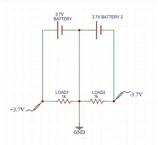

I believe that this is by far the simplest way to get negative voltage, if you can simply use two batteries in series and treat the mid point as GND. then the + side of the 1st cell will be your positive rail and the - side of the 2nd cell will be your negative rail.
aditya444
  • 183
    Downside of this is that if your loads aren't drawing exactly the same current, your batteries don't drain evenly. – Hearth Oct 01 '20 at 19:38

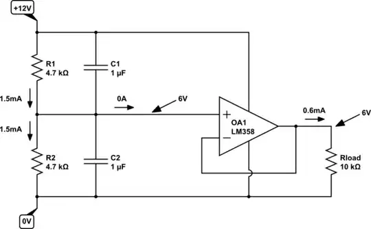

The little rail splitter circuit with two resistors and 2 capacitors is a poor design:
schematic
With R1 and R2 equal, you have a resistor divider which gets you a potential half-way between its top and bottom potentials. C1 and C2 simply try to keep that voltage steady as the power supply wobbles up and down slightly, but asside from that, they aren't much help.
The problem is that any current being drawn via R1 or R2, due to things connected to that mid-point (for example, Rload in the circuit on the right), will cause the center potential to to deviate from the required half-way value, so you have to be super careful not to "load" it in any way. Even worse, as the load varies (and it probably will), the mid-point potential varies with it.

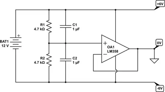

This is a reasonably good starting point though, because at least you get a nice 6V reference potential, that you can use to create a stronger, more robust 6V supply point. You can do this with a single opamp, connected as a voltage follower:
schematic
simulate this circuit
The opamp input draws no current from the divider, so you needn't worry about it ever loading and upsetting the +6V reference. It uses negative feedback to counter any influence that a load presents at its output, to maintain a steady 6V there even under modest load.
You can power this circuit from any DC source over 4V or so, reassign your ground point, and re-label the supply rails to more meaningful names. For example:
schematic
This will work quite well as long as you don't ask for more than about 10mA from the opamp (sinking or sourcing). More than that and you'll need a beefier solution.
Also, beware the dreaded ground loop. If your source of DC power is not isolated from mains Earth, you must not connect your new ground point to that same Earth, because it has a different potential.
