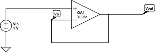

schematic
A typical way of analysing the unity gain buffer is:
Where A is Open Loop Gain
Vout = A(Vin - Vp) and Vp = Vout therefore
Vout = A(Vin - Vout)
Vout = AVin - AVout
Vout + AVout = AVin
Vout (1+A) = AVin
Vout / Vin = A / (1+A)
if A >> then 1+A ~ A
Vout / Vin = A/A = 1
I would like to get an understanding of how this works from initial conditions ie step response
At t= -1 Vin, Vp and Vout = 0
At t= 0 Vin = 1V and as Vp = 0, Vout = A(1-0) = A
As Vout = A then Vp = A such that Vout = A(1 - A) = A - A^2
Subbing again gives Vout = A(1 - (A-A^2) = A(1-A+A^2)
This is obviously just going to run away so must be incorrect, perhaps it is my initial condition assumption that is wrong?
Alternatively using the simplified model of an op amp:
Op Amp Simplified Model
I could assume that at t=0 Vp = Vin therefore Vout = Vin
However Vin = A(Vin - Vin) is a contradiction
Obviously this is a well known circuit so I must have a fundamental misunderstanding but what have I got wrong?

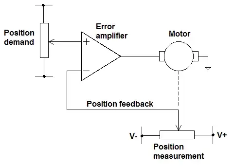

I'm trying to get an understanding of how negative feedback works.
Think of it like a control system and an error amplifier.
You set the "demand" on the non-inverting input and the negative feedback causes the op-amp output to rapidly change to a voltage that makes the input error minimal. In other words, the inverting input is made to be nearly the same voltage as the "demand".
Because the open loop gain is massive at low frequencies, the amount of error required to "drive" the control system into stabilization is quite small.
You can, if you want, regard the op-amp as a kind of motorized control system: -
When you grasp this, replace the motor and position measurement potentiometer with a wire link and you have a simple op-amp buffer. It's easy after that!

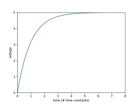

When you are considering a step response, you need to include the time delays at the different locations for the answer to be reasonable. One way to model this is to add an RC filter at the output of the op-amp. The other thing that you haven't accounted for is that the op-amp can't actually drive the output to greater than the positive supply voltage.
Taken in combination, and assuming Vs = 5V, this means after the positive input steps from 0 to 1, the output of the op-amp would follow a curve something like this, ignoring feedback for now:
capacitor charging RC response

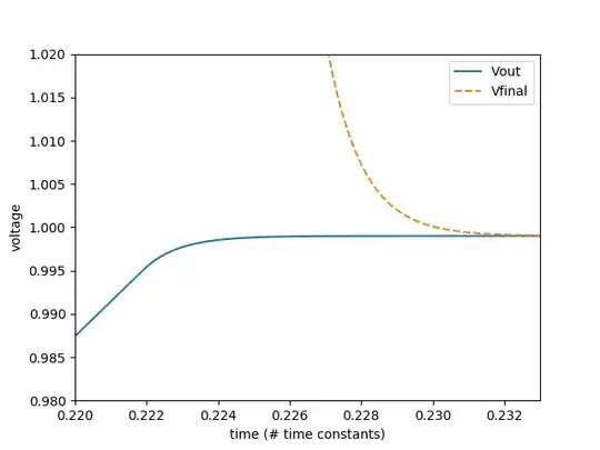

OK, now what happens if we do include feedback? Remember that the negative input to the op-amp is the same node as the op-amp output. Once the output starts to get close to 1 V, the op-amp will begin to drive less current. In particular, once \$V_{out} > 1\text{ V} - \frac{5\text{ V}}{A}\$, the output stops driving high as hard as possible. This doesn't mean it flattens out immediately, but the endpoint/goal of the RC settling starts to drop. I will call this goal point Vfinal and I've plotted it alongside Vout in the plot below:
Zooming in to the time when Vfinal drops: enter image description here enter image description here

  • This has helped clearly explain whats going on relative to time. It would be useful to have an even more zoomed in graph to show that once settled Vout != V+ as this was a sticking point for me. I've accepted this as the answer as its done the most to get my head around it but ill also add another answer to show the conclusion I've come to – andowt Aug 27 '19 at 08:15
