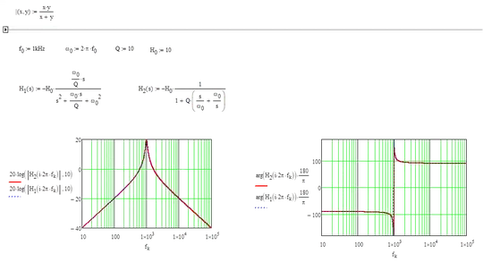

There are many ways a transfer function can be written. The best and only way is the low-entropy form, a term forged by Dr. Middlebrook when working on Design-Oriented Analysis. The transfer function must be expressed in such a way you "see" where the poles and zeroes are located and how they affect the response.
In your expression, factor the numerator \$\frac{\omega_0s}{Q}\$ while in the denominator you factor \$\frac{\omega_0s}{Q}\$ also. Re-arrange the whole thing and you should get \$H(s)=-H_0\frac{1}{1+Q(\frac{\omega_0}{s}+\frac{s}{\omega_0})}\$ which is the correct form for expressing the transfer function of a second-order band-pass filter.
The below Mathcad sheet shows that responses are identical. In your circuit, determine the denominator \$D(s)\$ using the fast analytical circuit techniques (FACTs) from which you obtain \$Q\$ and \$\omega_0\$. Factor \$N(s)\$ to match the formula I gave and your leading term represents the peaking gain \$H_0\$ (20 dB in the given example).

  • alright I've got to go to sleep now but I will run over your math tomorrow and give you feedback or accept your answer. Thanks for taking your time to explain! Just didn't want you to feel ignored for the extended silence in the meantime – Andrew Aug 20 '19 at 11:13
  • Good night then! – Verbal Kint Aug 20 '19 at 11:17
