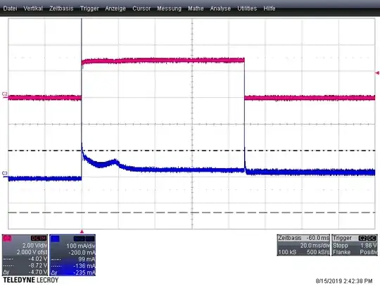

I have a battery powered application and want to somehow "protect" the battery from seeing too high currents. For that I have introduced a serial resistor to limit inrush current. After a certain time the resistor gets bypassed via a Mosfet.inrush limiter
It has an effect on the inrush current but it's still not like I would imagine it.
When meassuring with a current probe between the Battery and my circuit I can still see a peak when switching power on as well as when I activate the Mosfet (blue line). (red line shows voltage on uC pin)
scope
can someone explain what happens here and how to prevent those spikes?
//e: uC is a STM32 and configured as openDrain without internal PullUp/Down

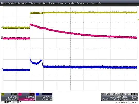

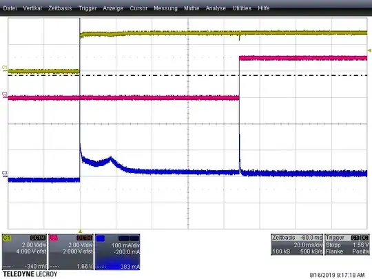

//e2: after adding a N-FET to activate the P-FET as suggested it looks like this:
//e3: so the first spike is still there, even when disconnecting the uC by removing R50 as suggested by @DKNguyen
//e4: implemented @Indraneel's Solution with C2=0.1uF and R2=500k and keeping R3 at the initial 18ohm. This could be a solution. Still curious why it is not working with the uC

  • Is that spike even a concern? It doesnt look long enough to heat up the battery. I think thats just the MCU booting up and being unprepared. To verify, remove R50. – DKNguyen Aug 15 '19 at 14:20
    @DKNguyen It's no big concern... but I do not even understand why it is there. – gloerk Aug 15 '19 at 14:24
  • @brhans right now the uC waits 80ms and then pulls the line low to activate the mosfet – gloerk Aug 15 '19 at 14:29
    Is your microcontroller's open-drain output "high-voltage tolerant"? If not it's very likely that at power-up you're sinking current from that pin into Vcc through the pin's 'parasitic' diode while Vcc 'slowly' ramps up from 0V. You'd probably have greater success using the micro to drive an external N-Channel MOSFET, which then pulls the other P-Channel MOSFET's gate low. – brhans Aug 15 '19 at 14:39
  • @brhans the pin is 5V tolerant. But since the uC is powered out of the same battery (after the inrush current limiter) it isn't even powered up when Vbat is activated. – gloerk Aug 15 '19 at 14:45
  • "can someone explain what happens here" - where did the circuit come from? Link please. – Andy aka Aug 15 '19 at 15:29
  • @gloerk how can you power the uC from the same battery after the inrush limiter and expect it to work? Use the mosfet standalone by adding an appropriate capacitor at the gate of the mosfet to delay switching it on. – Indraneel Aug 16 '19 at 13:36
  • @Indraneel can you explain why it should not work? Power after the serial resistor is still enough for the uC to work. – gloerk Aug 16 '19 at 15:19
  • @gloerk Well, I guess it could work. However a couple of things come to mind. Can you ensure that uC pin starts up floating or high, and not low? Also, mosfet gate has a capacitance, so may take a us or so to go high. What is your oscilloscope showing? What are the blue, red, green lines? – Indraneel Aug 16 '19 at 16:53
  • @Indraneel blue is always current measured between battery and the circuit. Red is the gate of the P-FET (in the second screen it's the N-FET). Green is battery voltage. According to the uC datasheet pins are floating input during startup/reset. – gloerk Aug 16 '19 at 17:08

  • sounds reasonable but it doesn't seem that it will do the trick. I added a screeshot of the scope in the initial post. – gloerk Aug 15 '19 at 16:10
  • @gloerk - You certain you hooked it up right? Your scope trace looks like the P-FET isn't switching at all now ... – brhans Aug 16 '19 at 01:29
  • Of course I did not. I updated the image above... – gloerk Aug 16 '19 at 08:42
This has a current limit of 300 mA. R3 can optionally be an NTC (e.g. 10D9). Mosfet needs to be logic level (SI2305 should work). Adjust C2 and R2 for your sweet spot (0.1u and 100K will also give same result). R1 is a load.
C2 when not charged pulls up the gate and prvents mosfet from conducting. When charged, R2 pulls the gate low and mosfet conducts. A bleeder resistor may be preferable somewhere in the circuit if device will be switched on and off repeatedly.
Output voltage (red), mosfet current (green) and 100uF capacitor current (blue). Increasing R3 will lower the initial peak. Changing to an NTC resistor will make the curve smoother....

  • I tested it. Result is in the initial post. Where would you put a bleeding resistor? Wouldn't it effect the whole function of the inrush piece? – gloerk Aug 16 '19 at 15:38
