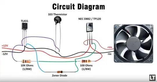

I'm new to electronics and I want to control a device using a temperature as an input.
Right now I saw this video on youtube and want to follow it as well as know what the components are for.
https://www.youtube.com/watch?v=PkRJBQgjLrc
From the video I know that the NTC MF52-103 is the temperature sensor and that its output is a resistance. I just don't know how to set/configure the resistance to the temperature I want to control as well as what are the purpose of the two other transistors.
Fan circuit 'diagram'

    What is it you want to do? You say you want to follow the video, but I watched it for about 30 seconds and it had no schematic (except a very crude cartoon) and had a fan going all the time. Is this what you want? Or do you want something to turn on at certain temperatures, or maybe off at certain temperatures? If so, what? You need to describe your goals a bit clearer. You should edit your question, stating your goals at the beginning, then say what you have tried, which can include the youtube video. Depending what your exact goals are, the circuit in that video may be no good for you – MCG Aug 08 '19 at 07:49
  • I added the closest thing that the video had to a schematic. For more information about what a schematic is, if you are unfamiliar, please see: https://electronics.stackexchange.com/q/105136/2028 – JYelton Aug 08 '19 at 22:20

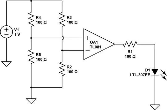

You could do something like in the schematic below. Let R2 be your NTC. It's probably best if you replace R5 with a potentiometer do be able to adjust your threshold. As long as V+ of the OPAMP is lower than V-, its output is pulled low so the LED will not be lit. With the temperature increasing, the reistance of R2 will drop and V- will sooner or later be lower than V+, so the OPAMP will pull the output high and the LED goes on. This just works well if you have one specific temperature threshold wo which you can calibrate the circuit. Keep in mind that NTCs have non-linear characteristics.
schematic
In a next step you could replace the simple comparator with a so called Schmitt Trigger to prevent the LED from flickering when the temperatur is exactly at your threshold.
Edit: I just saw that the video is a fan controller and not a temperature depending LED, so what exactly do you want? The video explains pretty clear what components are used and how they're assembled.

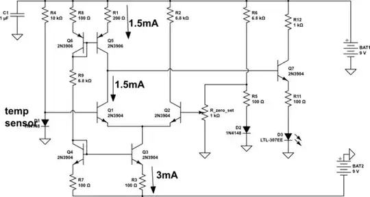

This circuit will do that

    This is not a very useful circuit for OP. The question states they are a beginner, and states they are unsure what the purpose of transistors are in the youtube video of a simple circuit. This is clearly going to be way beyond them to understand. – MCG Aug 08 '19 at 08:25
