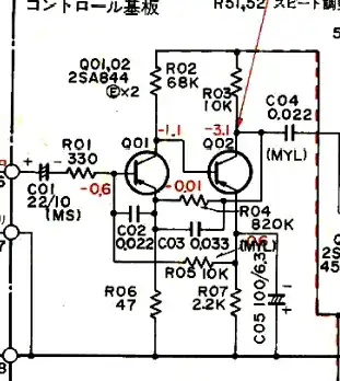

I'm looking at a schematic for an old turntable that I am needing help on when viewing the capacitor values. All of the polarized caps will have 2 values written next to symbol i.e. C01 22/10 (MS). I'm assuming one is the voltage and the other is the µF rating.
My Google-fu was not strong enough to find this answer so apologize if it has been asked previously.
Schematic Snip

It almost always denotes capacitance / voltage rating.
Capacitance in µF, voltage in VDC.
For example:
  • 100/6.3 would be 100 µF, 6.3 VDC
  • 22/10 would be 22 µF, 10 VDC

    If @kernisme has the old turntable available, it should be easy to confirm this -- at least some of the electrolytics should still have legible markings. – jeffB Aug 08 '19 at 16:15
